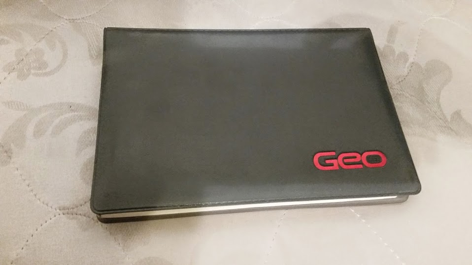

OHHH and before i forget....
i order an owners manual on ebay :)
its in amazing condition, i figure if im doing all this i might as well make it complete :thumb
