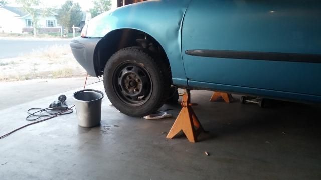

Center radiator support like mentioned and I put the jack stands under the factory jack points. I don't like metal on paint however, so I usually have a shop rag I put on top of the stand to lower the car on. Seems to work well. I've also used 2x4 cutoffs too but the rag is much gentler on the paint.
It would be a good idea to keep a rag wrapped on the scissor jack too so if you need to use it on the roadside, you're not damaging the paint there as well.
