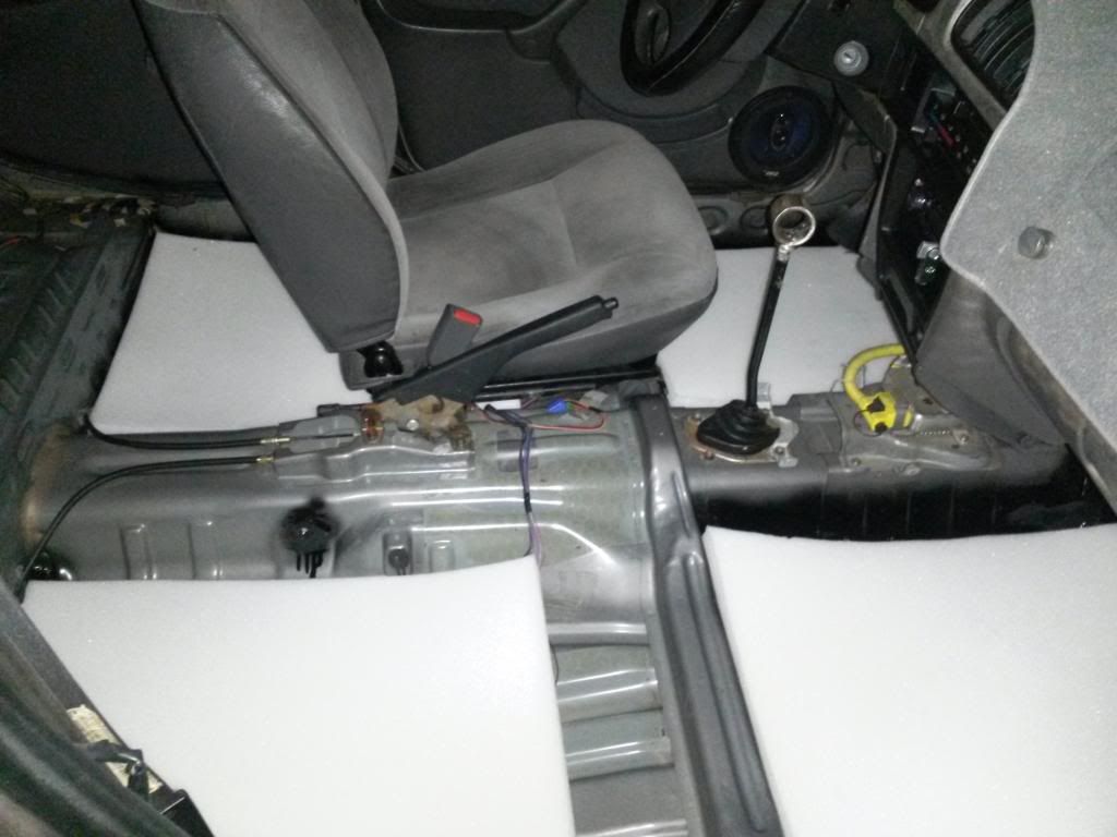

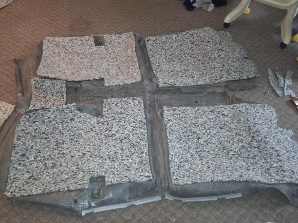

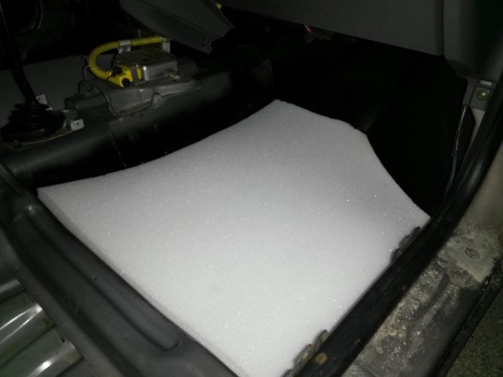

so i took someone's advice and am replacing the insulation on the carpet with a more "stock" material. i cut pieces down to size then im sewing the four corners to the carpet itself. im still putting the cushy stuff underneath it all though. and i still havnt pulled the dash. i did install my keyless locks today. yay :)

so here is my finished product after some tedious sewing. glad that's over :die
