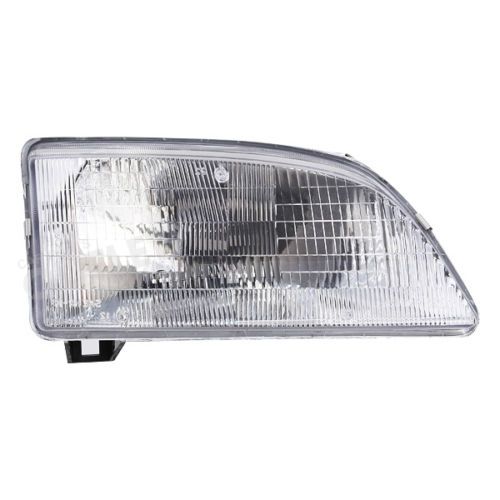

here is an alternative 22 dollars each on ebay they fit minor wiring required. 89 to 94 metro and swift![]() http://www.ebay.com/itm/89-94-GEO-METRO-HEAD-LIGHT-LAMP-ASSEMBLY-RIGHT-NEW-R-H-/140580647039?pt=Motors_Car_Truck_Parts_Accessories&fits=Make%3AGeo%7CModel%3AMetro&hash=item20bb42707f&vxp=mtr Edited by socal geo garage, May 26 2014, 11:49 PM.

If you get that one from ebay your going to need the mounting brackets and the bulb pigtails as well...try to locate a LSi Metro 89-94 and they will fit...

Those are great lights. My swift came with those. Should not be difficult to adapt.![]() This is what it would look like on a GEO.

There are two different headlights, the ones are posted above are different. Swift headlights in my perceptive are nicer but you need a new hood and new upper bumper lid. When I did my swap i got all my parts from a donor car at the junkyard, I cut the pigtails and I just re wired the harness from the old one, there might be adapters out there but oh well. Best option it to keep and eye at the junkyard for a donor car or teamswift, they part out cars sometimes and you can make and offer on the whole assembly. |
