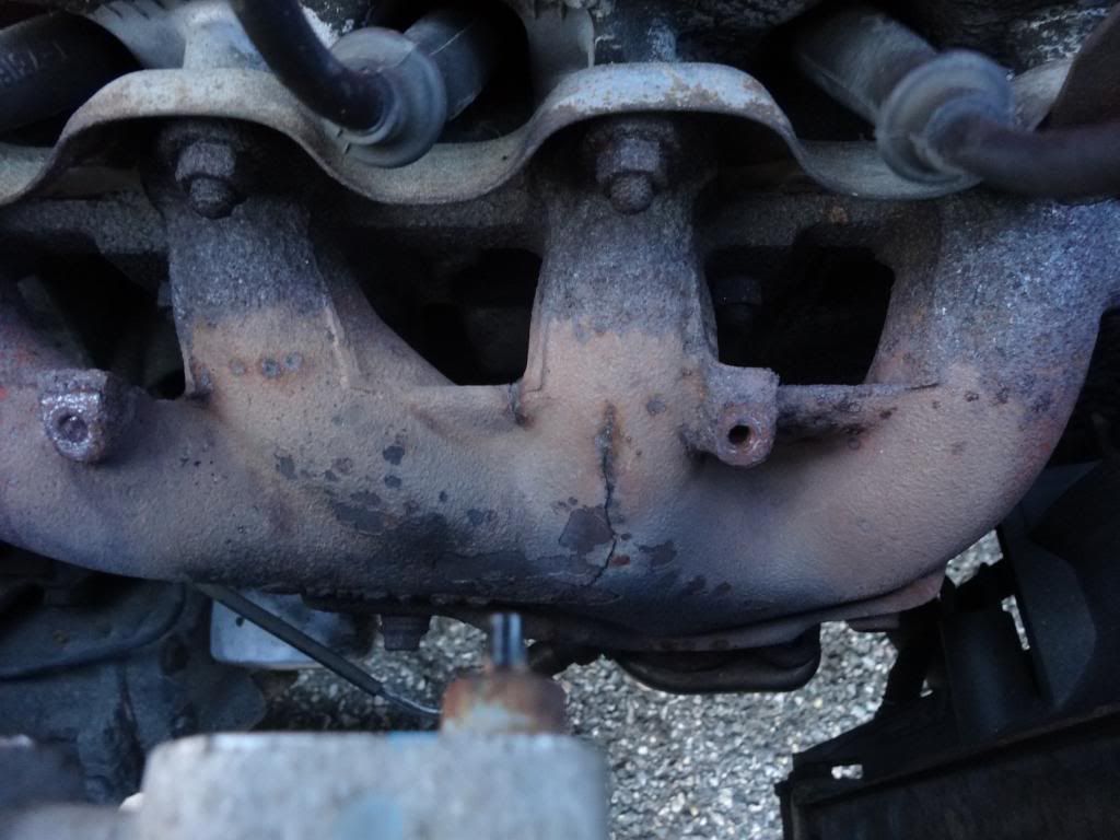

Anyways, today went ahead and put the pipe back on. I took the heat shield off so I could make sure the pipe lined up with the exhaust manifold properly. Doing so I noticed underneath the heat shield, there was a crack in the exhaust manifold (pics below). Well despite that, everything fit perfect. I went and started her up, everything was fine and I noticed that there was smoke rising off the ex. manifold.... Also the car seems to run fine for a few seconds then it sounds likes its about to stall out and kinda shakes a little. Then it runs fine, then repeat. Sometimes it sounds like its going to just shut off. I HAVE NOT reconnected the downstream 02 sensor which I am pondering if that not being attached is making the car run like that....??

So, is what could the smoke be? It looks to be rising off the entire manifold, not like its coming out of the crack. I havent spilled any oil or anything on it so I dont think that its burning off anything. Its really starting to bug the hell out of me because I dont know how long its been cracked or smoking.... is it safe to drive or will it catch fire?

That engine of yours sounds funky, like a walrus with a bad case of the poots. Not having your O2 sensor plugged in certainly isn't helping it run any better. Engines will become "choked" when an 02 sensor is unplugged or not working properly because the computer is just running off of what it knows. You should obviously plug the O2 sensor back in and probably replace that manifold. You don't want to weld something too many times, you can cause stress points that will crack more. If you can't find a new manifold I suppose you could weld it but I would think it easier to simply replace with a known good piece.

I have been searching my @$$ off for a replacement manifold. nothing on ebay. I have been messaging sellers that have used 1.3L to see if they have any, no replies yet. If i dont hear anything the only thing I think ill be able to do with manifold is weld it. What type of material is it? Metal? Cast Iron?

It's cast iron, not really weldable according to what I've read. If I was gonna redneck it, my first attempt would be exhaust patch kit and then a wrap to try to keep everything in place.

It can be welded but not easy. Have to drill hole at each end of crack so crack will not go any further then groove manifold the full length of crackin a v shape. Then heat manifold red hot where you are going to weld it and use cast iron rod to weld. Been doing it for years. Blocks and hard to fing manifolds. Has always worked and never cracked. Mainly been on very large engines like Cat,Cummins blocks and Manifolds. Have welded hard to find manifolds on big block fords and dodges. it can be done just a lot of work to do!

since I have been unable to find a replacement, i talked to a buddy of mine who had something similar happen. he said he used high temp jb weld and it worked fine. Its going to be a temporary, patch (rather than a fix). The stuff I got wasnt actually jb weld, it is CarGo Thermosteel Thermosteel 2400°F Cold Weld. It says "Thermosteel is engineered to withstand temperatures up to 2400°F and to withstand direct flame. Use Thermosteel to repair furnaces, BBQs or other high-heat item to fill cracks, holes and pits. Strength is designed to increase with heat.".. which doesnt always state the 100% truth. Reviews on there seemed good, most of what I read on google seemed like its a decent product.
I got home, cleaned the area around the crack, mixed it up real well then applied. At first I seemed very skeptical, it seemed like water with finely ground steel in it. Within a few minutes it started to thicken. By the time I got cleaned up, the stuff was already hard to the touch.

Why not just braze it?
You can do that with a good hot torch...

I had the same issue when I did my 1.3L rebuild. Every 4 cyl at the PnP was cracked and like you have found eBay is no help there. I ended up getting one from the gm parts giant.
