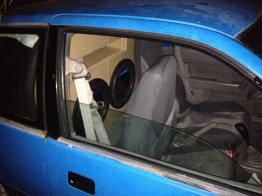

I'm running an MTX1501D which is 1500WRMS at 2 ohms. I'm running it at 1 ohm and should be seeing over 2000WRMS, possibly 2500. I have a stock alt, but I only jam it for short periods of time and it runs pretty good with just an extra battery, although I need to get another.
Wow...def needs tint
