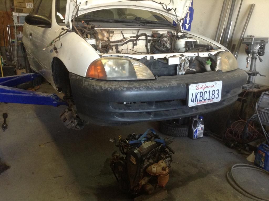

One of my daughters has been driving my 1997, and is away at college. (UC Santa Cruz) She called me and said she was having antifreeze problems, so I pulled this one into the shop this morning to get it ready for a Metro swap. I don't really know what the problem is with the one she is driving now, but I figure I will load up some water jugs and some tools into this one when it is ready, and drive the 97 back here. I have another 2000 3/5 out in front of the shop that is wrecked, so I pulled the motor out of that one this morning as well. Just taking a little break before I load the new used motor into this car. Hopefully no problems, and I can drive this one home tonight.

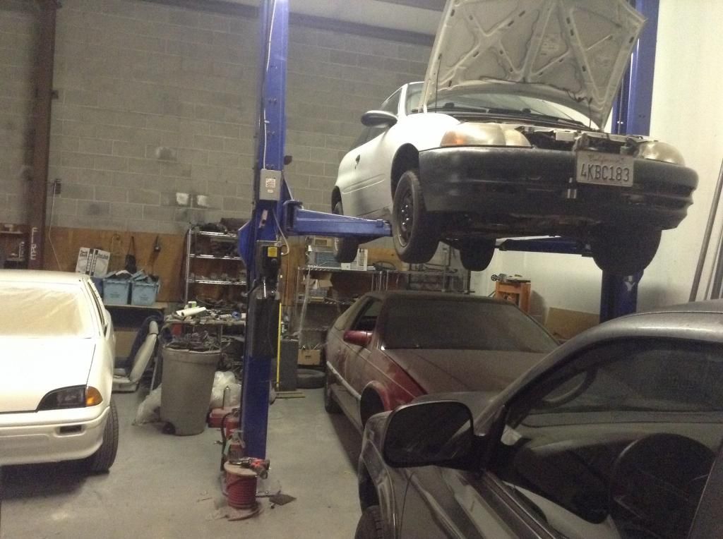

Everything went smoothly with the engine swap, and she fired right up like I had just driven it 5 minutes ago, other than a little cough. The Brian guy that I bought the wrecked donor 2000 3/5 from apparently took really nice care of his Metro. He had robbed the fifth gear for his beautiful XFI, so I transferred my 4.10 that I had just put in this one over to the new motor. When I checked out the clutch to see which one was better, the one on the donor 2000 looked brand spankin new, so I left it on there. I did not even unbolt it to verify the rivet depth on the friction plate since it was obviously really new. Anyway, I did not have any synchromesh or substitute oil to fill up the transmission with, so no test drive home in this one tonight. I have a little mattress that fits in the back of my pickup here at the shop, so I will crash here tonight and get some tranny oil in the morning and take it for a drive.
All the cars are in for the night, and this is my bedroom tonight...
