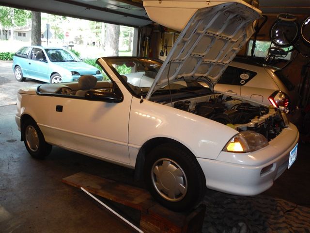

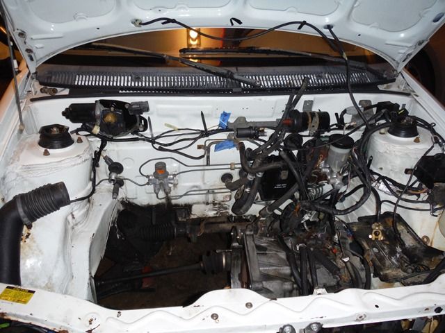

Finally had a chance to give it a little look over.

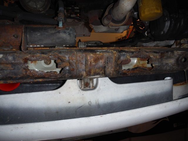

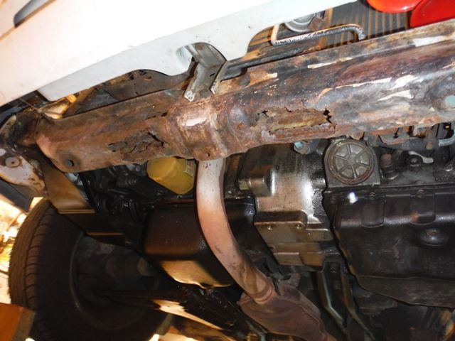

I'm not liking this lower radiator support. :'(
That is one big garage door opener over the hood, must be strong... :lol
I have a lower rad support off of a 1996 hatchback Base Metro, not sure if it would fit a older Vert, and shipping would be $$$$$ from Seattle...but if you know it will fit and want to try shipping let me know. ^o)
I drilled out all the spot welds to get it off and had to pry a bit so a couple edges are bent a little, but I think a hammer will get them back to the correct spot. This may be the deal breaker...it's green not white... :lol
Edited by brsja, May 25 2015, 08:22 PM.

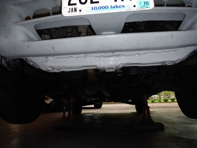

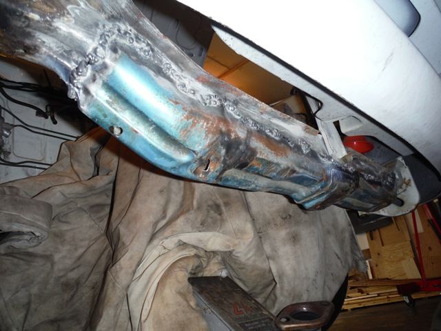

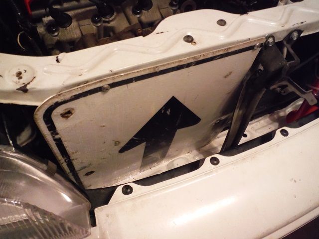

Thanks for the offer. But I think the 95+ are wider. :hmm Anyway, I opted for a boot, or sleeve, of sorts method. I fileted the old Ice Blue, bent up support, for the sleeve.
Hammered it back, into shape, and prepped for welding.
Used C-clamps to press on and weld.

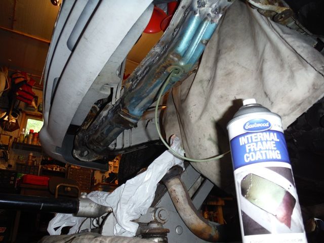

It ain't pretty, but is light years better than it was. I soaked down the inside with this stuff.
The exterior was soaked down with Permatex Rust Treatment. Hopefully this will slow down the inevitable. :'(

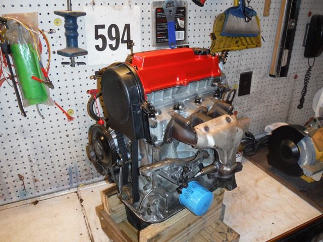

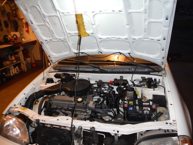

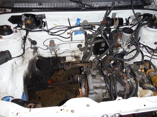

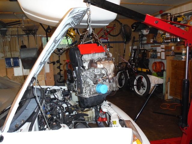

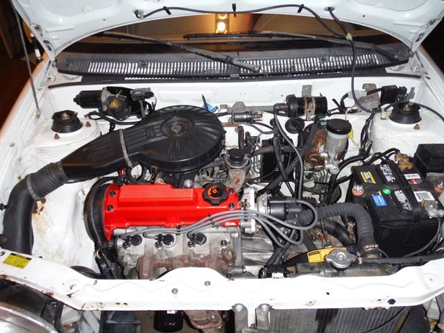

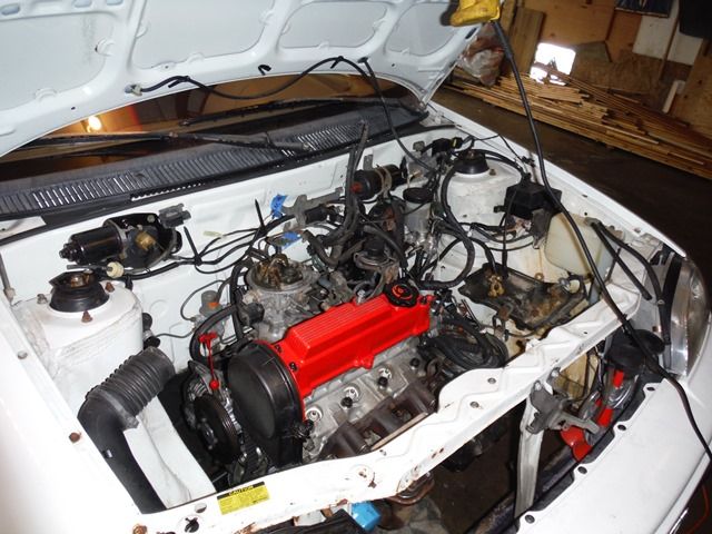

Time to drop in the engine while things are drying.
It's in! :thumb
Now I have to get the rest, of this stuff, put back on. :gamerz
Was quite a weekend. ^o) Will hit it again tomorrow night. :cheers
Progress looks great!

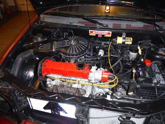

I just couldn't leave that ugly lower radiator support as is. Added a generous amount of seam sealers and then a coat of paint.

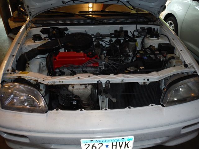

Engine is complete and running! :thumb
I'll post a couple videos in a little bit. :coffee They turned out a little blurry this time. :hmm Stay tuned. :popcorn

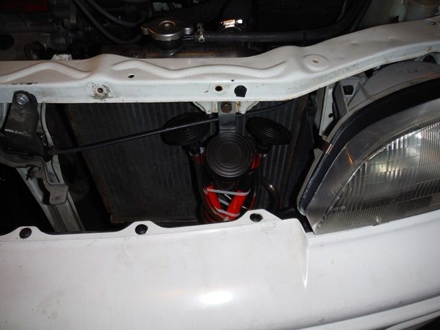

Tonight, I hope to fabricate a bug guard/AC delete plate, double check everything, and re-install Kim's horns.

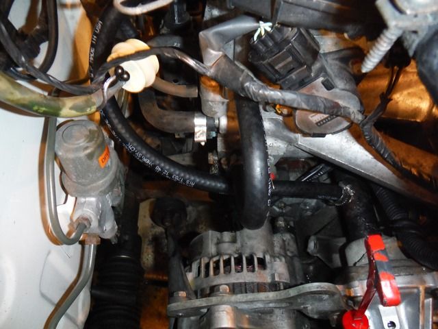

The coolant leak ended up being these TBI hoses.
I normally replace All hoses when doing a re-fresh. ^o) This time, since this was a quick "get it on the road" build, I re-used the ones that looked OK. :smackface Word to the wise, when the engine is out, change them all. :banghead Your back will thank you. :wub:

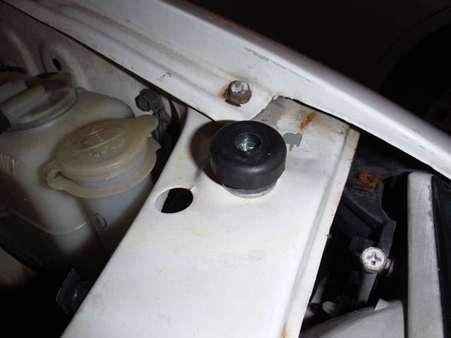

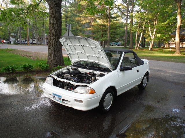

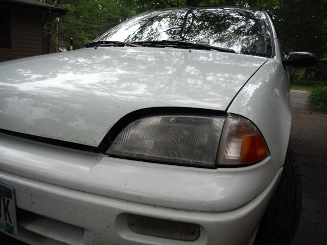

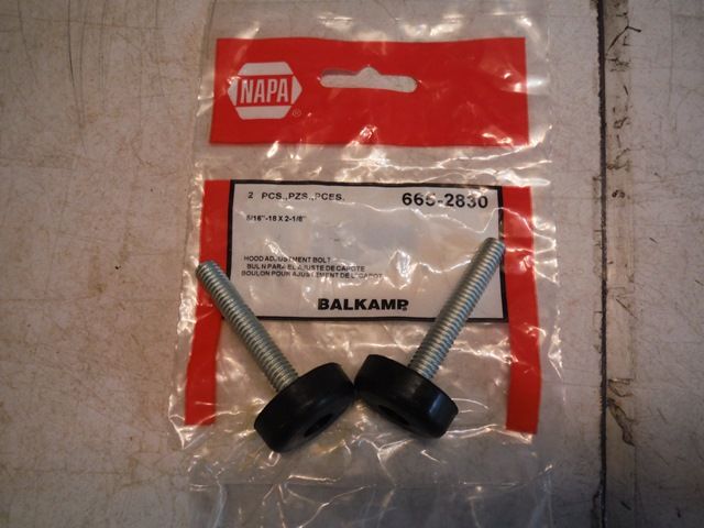

Kim & Jim's hood bumpers were missing. The hood latch was taking a terrible pounding flopping around like that. :'( Napa has these nice, adjustable stoppers. :thumb
No more rattling hood! :banana
Took it for a little spin. Engine runs, and performs, great. :drivin

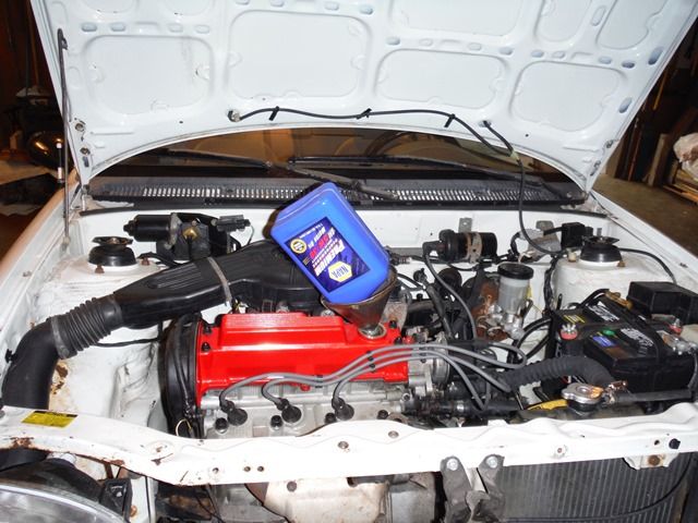

The coolant fan Did turn on this time. But the gauge only read about half. :'( Installed a new sender from my spare parts. :gamerz After giving it a good run, to seat the rings, I changed the oil.
http://www.mototuneusa.com/break_in_secrets.htm
Should be rinsed out, and ready for the next 500 miles. Then we'll change to "the good stuff" for the normal oil change cycle. In this case, due to driving style, Should be 3 months or 3000 miles, which ever comes first. ^o) Jim, are you reading me? :fon :-/ :lol

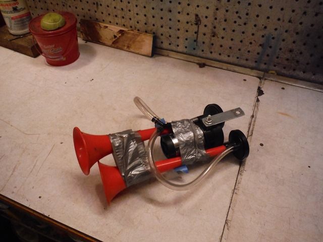

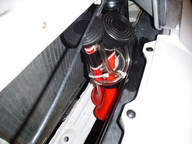

Horns are installed.
Still had to use a little Gorilla Tape, but they're a lot more solid than they were.

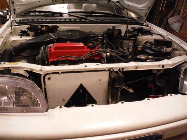

Custom A/C delete panel.
I had to place, the panel, on the outside due to the air bag sensor. Now Kim & Jim have an A/C delete panel like their son Nate.

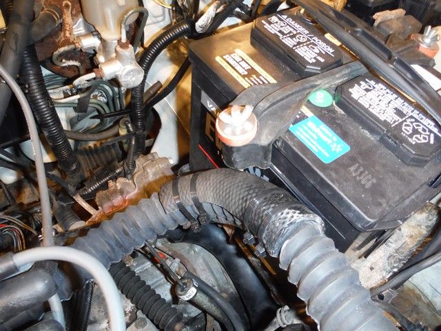

When using a universal upper radiator hose, there's a rub point next to the battery. Just use a piece, of the old hose, for a nice guard. :thumb

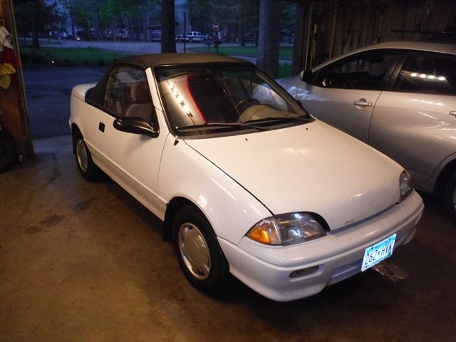

Time to put the little buddies back in the garage.
And no, that's not a gas leak. :lol At least, I don't think so. :hmm ;) Just the last remains, of the monsoons, over Memorial Day weekend.
I'll take the convertible to work today, and run errands, to double check everything. I think we have a runner! :cheers

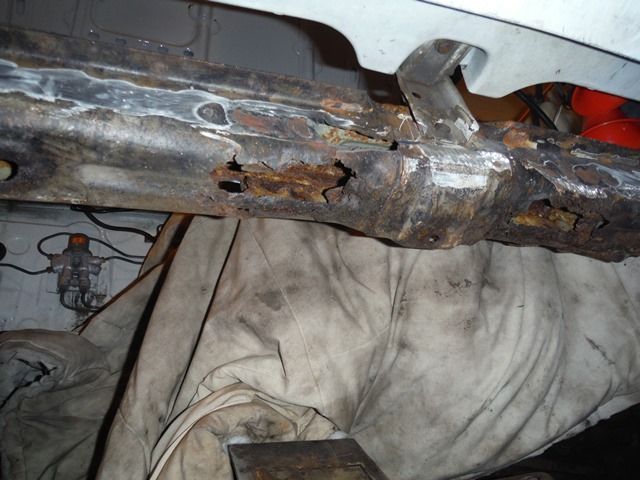

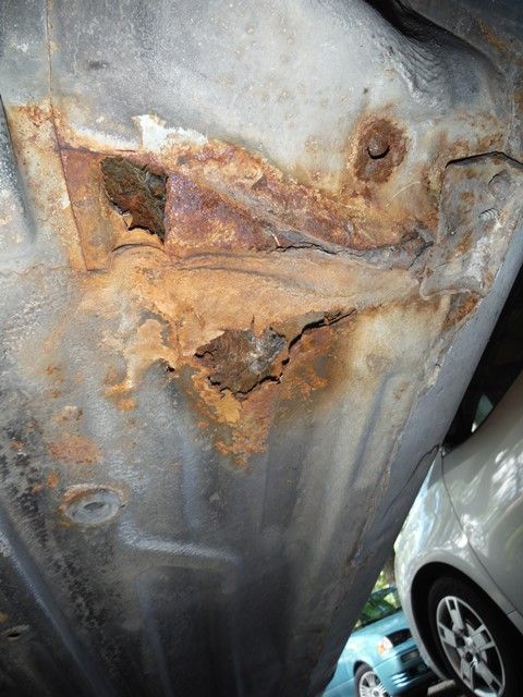

Car was delivered last night. :drivin They seem please with the results. :thumb Next we need to tackle the floor rust. :gamerz
