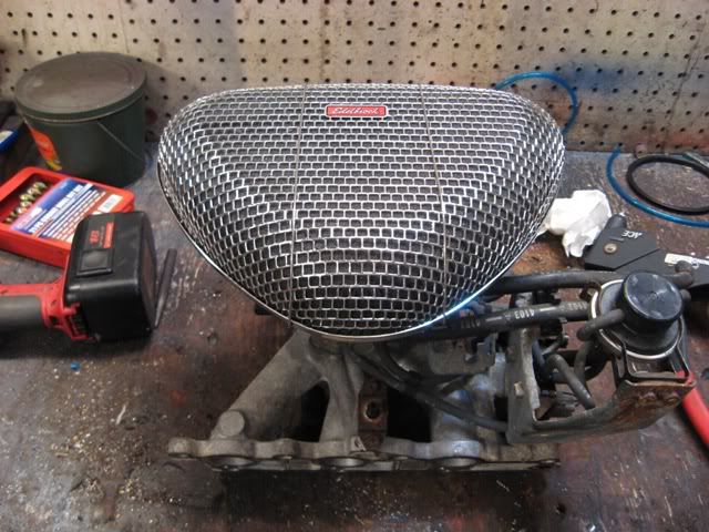

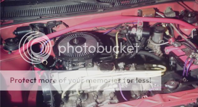

A little more searching and snowfish, metro_neel, VWguyBruce and t3ragtop all posted pics in snowfish's thread: Edelbrock Air Cleaner Install![]() I used this once, it involved cutting the air cleaner top off... ![]() ![]() I may go back to that to see if I get better than 41 mpg around town town doing short trips, with nothing over 7 mi.

that looks super badasss i must have something like that on mine! |
