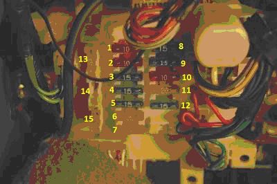

First off, Welcome to the Party! Just for reference, here's what the fuses do............... ![]() 1 - Left Headlight: High Beam Indicator (10 Amp) 2 - Right Headlight (10 Amp) 3 - Parking Lights; Side Marker Light; License Plate Lights; Instrument Panel Lights (15 Amp) 4 - Fog Lights (15 Amp) 5 - Hazard Lights; Horn (15 Amp) 6 - Ignition System; Gauges; Warning and Indicator Lights; Radiator Fan Motor; Automatic Transaxle Speed Sensor (20 Amp) 7 - Heater; Air Conditioning (20 Amp) 8 - Stop Lights (15 Amp) 9 - Lighter; Radio (15 Amp) 10 - Backup Lights; Turn Signal Lights (10 Amp) 11 - Rear Defogger (20 Amp) 12 - Front and Rear Wiper/Washer (15 Amp) 13 - Not Used (20 Amp) 14 - Not Used (15 Amp) 15 - Not Used (10 Amp) The space below #12 is for testing codes. If you have a spare 15 Amp fuse, put it in there, turn the key on and the Check Engine light will flash. Flash...pause...flash/flash is 12 and means all clear. Fuse number 10 is good?

thanks for the fuse diagram, any leads on what could or would cause the blinkers to just stop functioning, all the wires test good from the connectors to the blinker assembly. I am going to try another blinker relay. the solid state box on the blinker assembly seems to test good from top to bottom. |
