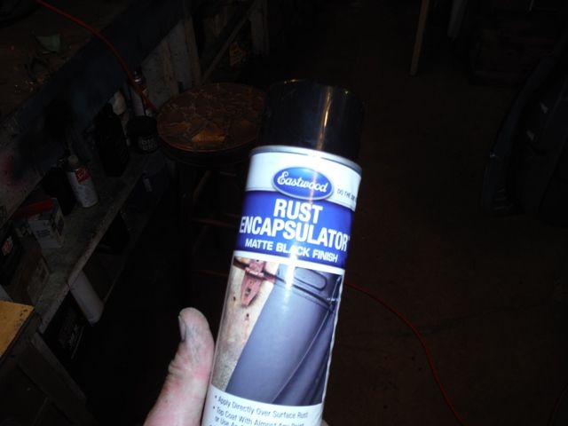

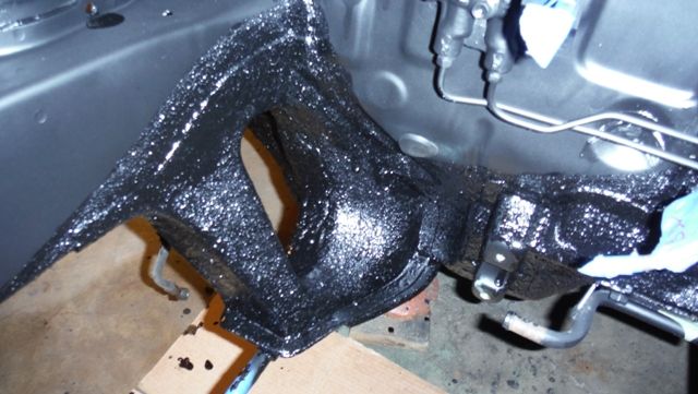

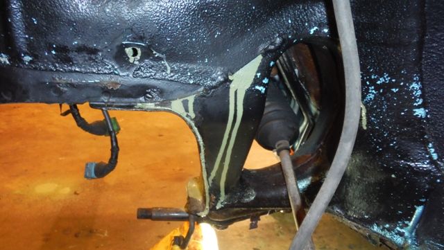

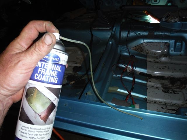

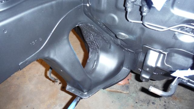

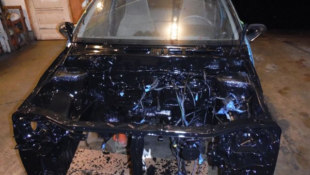

Hey sailor, that's why "if it moves, salute it. If it doesn't, paint it!" And with good old lead base paint. Haze grey and underway. Some products, that I've used, and work really well is Permatex Rust treatment, Eastwoods Rust Encapsulator and Eastwood internal frame coating. ![]() ![]() ![]() ![]() Soak it until it drips! Externally I used lots of Eastwood Rust Encapsulator. ![]() ![]() Followed by a good coat of Herculiner. ![]() The Herculiner bedliner provides an extremely tough finish and helps seal the gaps in out spot welded uni-bodies. Then a top coat of nice, gloss, Tractor enamel. ![]() My current project used a dozen cans each of the Eastwood Internal & External coatings. Plus over a gallon of Herculiner bedliner. The war on rust never ends.

Ok, where do you get the stuff you stuck in the rockers? How much $$$? |
| snowfish | Jul 15 2014, 06:09 PM Post #9 |
http://www.ebay.com/sch/i.html?_trksid=p2050601.m570.l1313.TR0.TRC0.H0.Xeastwood+internal+frame+coating&_nkw=eastwood+internal+frame+coating&_sacat=0&_from=R40 Spendy for some, very much so worth it for others

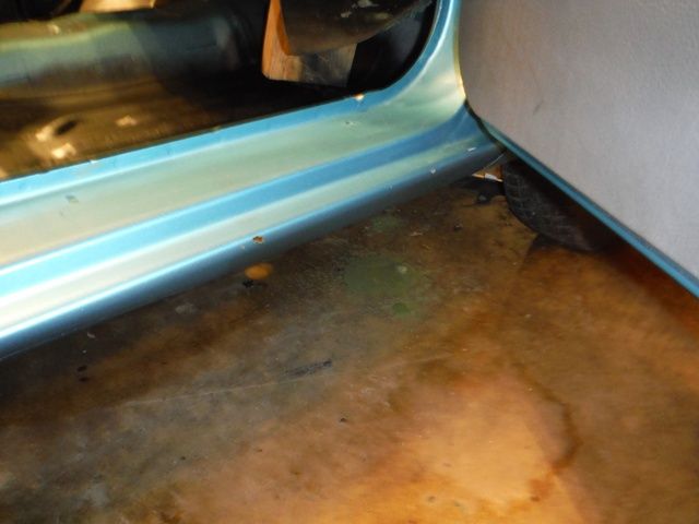

How do you knock the rust off the interior of the rocker panels? Or do you just apply eastwoods on top of the rust inside of the rockers? |
| Car Nut | Jul 15 2014, 06:30 PM Post #11 |
How do you access the rockers? Have to drill holes? (Maybe went through the holes for the rocker trim shields?) I just sprayed my radiator support & frame horns last night & this morning with the Eastwoods internal stuff. I've heard of some people filling the rockers with expanding foam. Supposed to smother the air & keep out water, so they say.

car nut, i always advise against using foam to fill any voids on a car. if you have to weld on them, the foam breaks down from the heat and creates a toxic vapor. most professional welders will refuse to weld on a car done like that. ![]() you access the rocker voids using the big access holes in the inner rocker under the carpet. you may have to pop out some plastic plugs. then you use the holes in the door frames/ tops of rockers where the push pins hold the trim on. pop the fasteners out, pull the trim off, stick the applicator tube through the holes, push the spray button, and draw the tube back. the applicator tube has a brass tip that provides a hemispherical spray pattern and it floods the inside of the rocker. the internal frame spray has a pea green phenolic coating with a high zinc content. the zinc chemically bonds with the iron oxide and the phenolic binds the steel to prevent air and moisture from coming into contact with it. |
