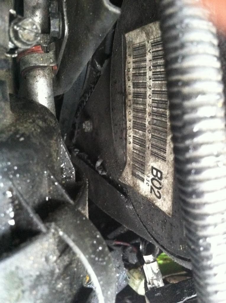

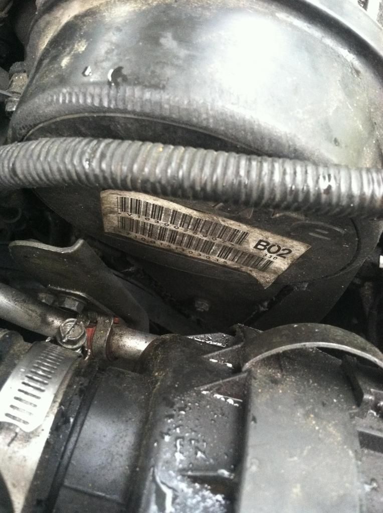

Hey guys! I have been poking around this site for a few days and it has been a lot help to me. I have learned so much more about my car! Here is my scenario: I have a 2001 Chevy Metro that I purchased 11 months ago. At the time of purchase, the timing belt, water pump, a/c and alternator belts, spark plugs, and O2 sensor were all replaced. since that time I have had a rough idle and a cylinder #2 misfire off and on. Replaced the spark plugs again but saw no change. Fast forward to now- the timing belt has gone out again. It has eaten through the cover and the belt is exposed. I can't understand why, other than that the tensioner was not replaced by the shop when the belt was replaced months ago. Since the car has 240,000 miles, I wanted to research if it was even worth replacing the timing belt. Shops were quoting me $750 for the job and warned me that with an interference engine I would likely be looking at a 3,000 valve replacement. Obviously not worth the value of the car. I have now discovered through this site and Wikipedia that these cars have a non-interference engine. (this IS the case, right?) My question is that most auto parts stores have the timing belt kit for this car listed as for an interference engine. Will this type of belt and tensioner still work for this car? Or can somebody point me in the right direction of what to buy? Edited by Jess, Jul 23 2014, 05:05 PM.

Thank you for all of your help, Allmountain! As far as I know, though, my engine is a SOHC. I only say this because from my understanding of the pictures on this site, mine looks to be a single. I could be wrong though. I will try to get a picture up, it is pretty interesting looking the way the belt melted away at the plastic of the cover. |
| Jess | Jul 23 2014, 09:34 PM Post #10 |
![]() ![]() SOHC? Edited by Jess, Jul 23 2014, 09:36 PM.

You said it was rubbing on the cover. If so this heats the belt and weekens it. Also, if you have an oil leak on the front main or cam seal, this can cause the belt to fail prematurely as oil causes the rubber to deteriorate. Or if you drive like me, redline shifting all the time, they don't last more than a year. I just replace mine every fall. The belt only costs 19.99 anyway. EDIT. just looked at your pics again and I can see where it has worn thru the cover. Usually a blet will wear thru a cover because someone didn't put all the bolts back in so the cover warps from the heat and lack of anything holding it in place to keep its shape. Edited by allmountain40, Jul 23 2014, 11:42 PM.
