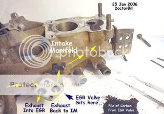

you can try disconnecting the exhaust manifold where it meets the engine and cleaning out the egr port on the driver's side-you can then clean the egr passage in the engine block towards the rear from where the exhaust manifold bolts on-then with the egr valve off you can clean the passages from the valve towards the front of the engine and then from the valve towards the throttle body-these areas are harder to clean due to curves in the passage-then you can try cleaning your old egr valve
:gp
Here's a thread on; Metro EGR System
A quick check is to remove the EGR and start the engine. See if you feel compressed air coming out the left port and a vacuum on the right port.
Some threads for your information on cleaning EGR port:
