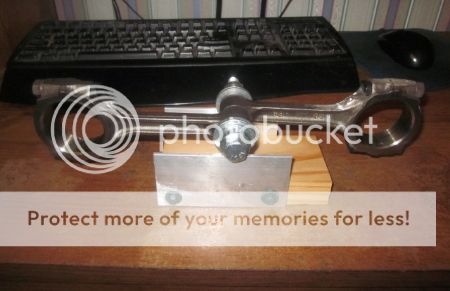

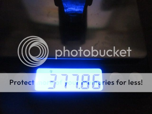

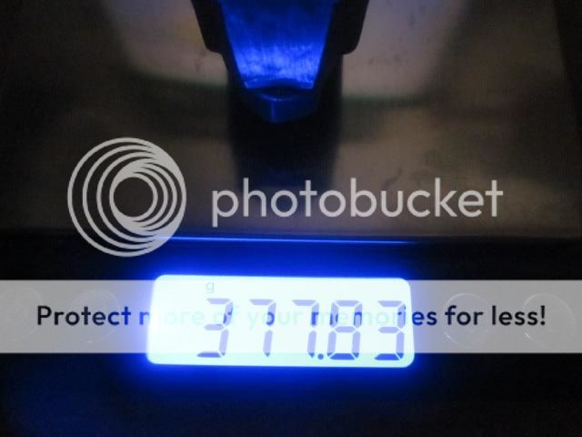

Taking my head and block this week to the machine shop. Before taking it I wanted to try and balance the rods. Got them done today.
Just followed clarkdw's guide to do it. Couldn't find a c channel so constructed my own. Turned the wrist pin down and a drill press with some 120 grit sandpaper until I had a slip fit into the rod.
Here's some pics.
perfesser
You'll be amazed at how smooooth your engine runs when you get it back in! I balanced my rods (didn't have to on the pistons, they were already perfect!) and that little mill just sits there and purrs!
