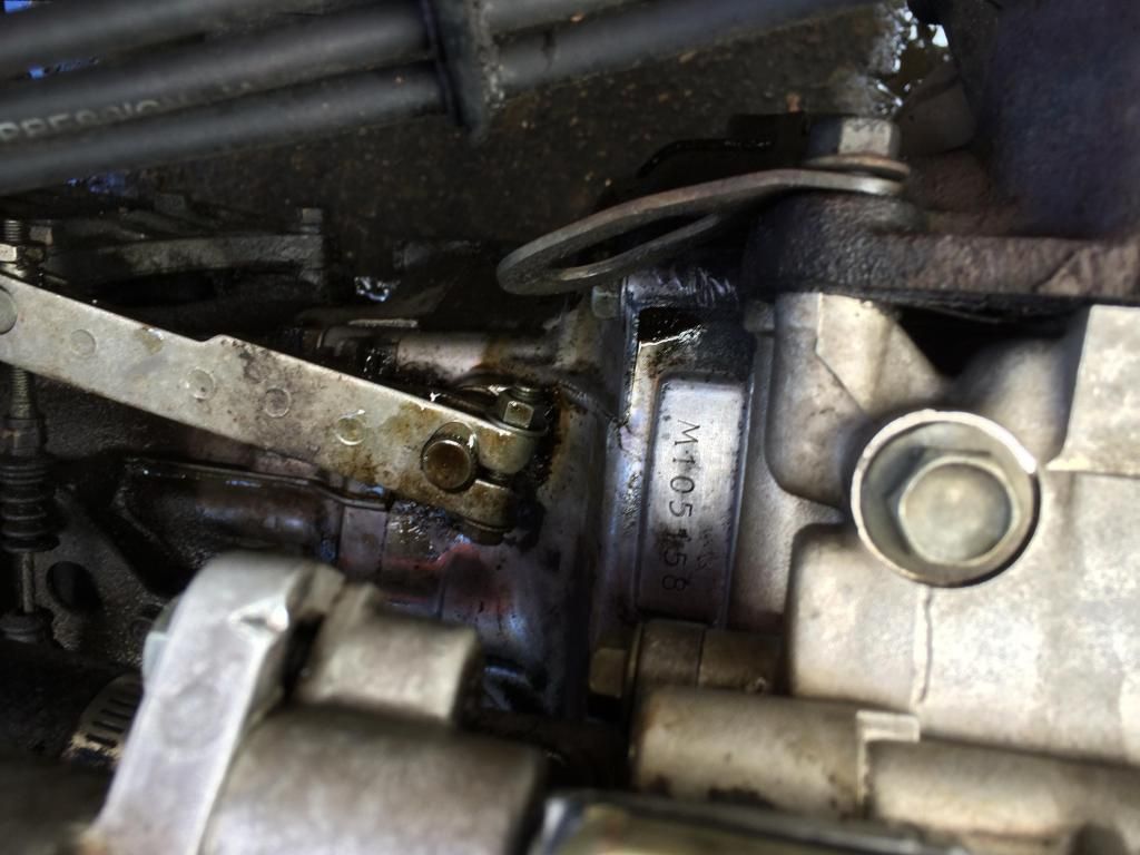

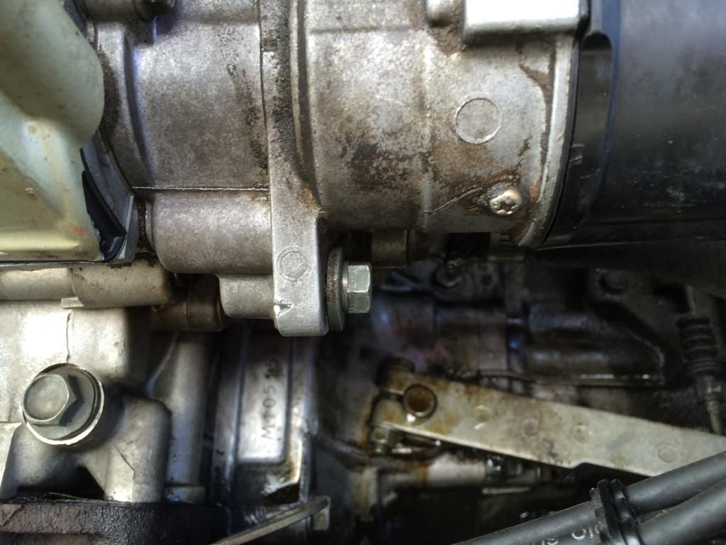

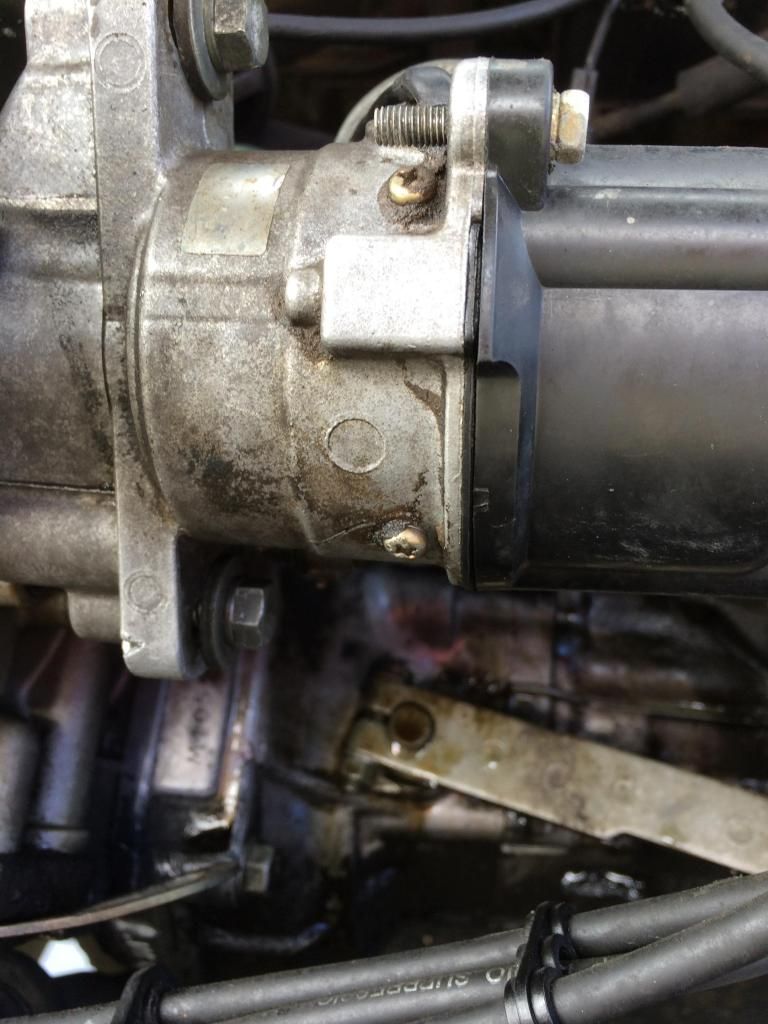

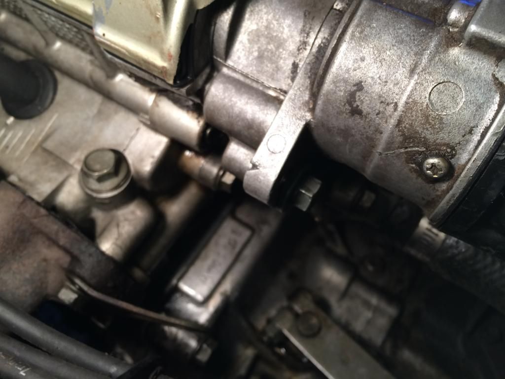

Hey everyone, I am new to the Geo crowd, but have been an admire for some time. I recently purchased a 1991 Geo Metro and I am going through maintenance checks and fixing things. I have an oil leak on the driver side of the engine. I have tried to replace the distributor O-ring already, but the leak is persisting. I check it every time i run her. Any ideas would be greatly appreciated, I am about to purchase an engine gasket kit, but I am wondering what the gasket is that is passed the distributor so that I can order that one. Please help. Thanks! [IMG][URL=http://s1240.photobucket.com/user/GhostGeo85/media/photo1_zps128a559e.jpg.html] [/URL][/IMG][IMG][URL=http://s1240.photobucket.com/user/GhostGeo85/media/photo2_zps8ceca81a.jpg.html] [/URL][/IMG][IMG][URL=http://s1240.photobucket.com/user/GhostGeo85/media/photo4_zps6c96ea26.jpg.html] [/URL][/IMG][IMG][URL=http://s1240.photobucket.com/user/GhostGeo85/media/photo3_zps457f8676.jpg.html] [/URL][/IMG]Kyle |

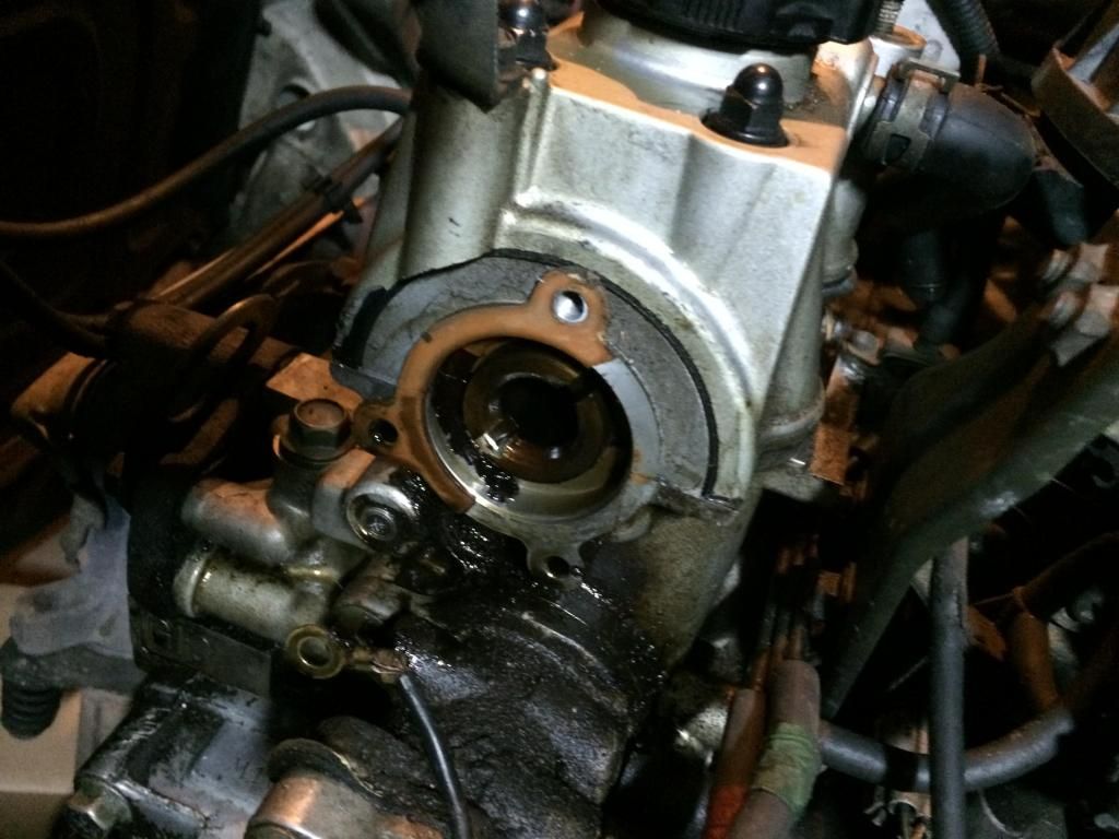

I found the culprit but looks like the housing for the bolt is cracked as well. Anyone know what this gasket's name is?
| Bad Bent | Aug 7 2014, 01:22 AM Post #3 |
Maybe it's just the angle of your picture or the pics in RockAuto but theholes look different to me, symmetrical on the engine, asymmetrical on the gasket . Anyway there is one on eBay called the Distributor Housing Gasket: Search 1991 Geo Metro Distributor Housing Gasket ~$7.50. From http://www.rockauto.com/As for the crack, maybe some JB Weld and filing it flat. Or it may be a moot point with the right gasket.Oh, to answer your question, you can name it whatever you want. http://www.thenewparentsguide.com/most-popular-baby-names.htm
