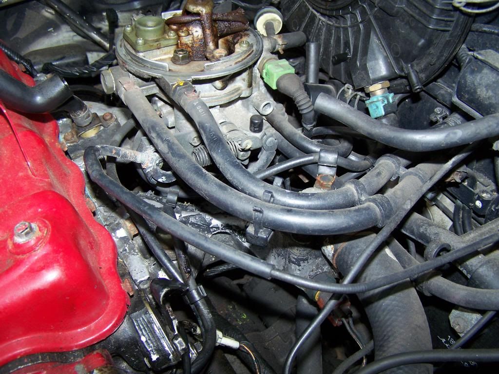

...well, it can't be the EGR because I do not have one - if I do, it looks nothing like a typical EGR value should look.
Is EGR Cali emissions only? Seems like it according to the FSM.
I've looked for the last 1 hour, reviewed my FSM for my Swift and been on both GeoMetro and Team Swift forums.
The sticker under the hood sez 6 BTDC - I see what it is currently set at and go 2 degs pass that.
I'm also going to put new spark plugs in it and run some 89 octane thru it while using this:
Just need it to pass it this one last time - after that it gets a waiver for being over 25 years old.
Move out of an emissions state. Come to Arkansas where polluting the air is the state pastime.
Heck, TimmyD, after seeing your TB, it is no wonder why your failed emissions. Clean that TB and find the reason why it is building junk up on it.
I thought they all did that. :D
Pulled the first plug...smells rich.
