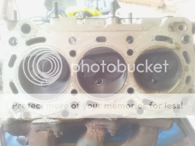

So I dug up a pic of a Metro head with a burnt valve so you know what your dealing with...

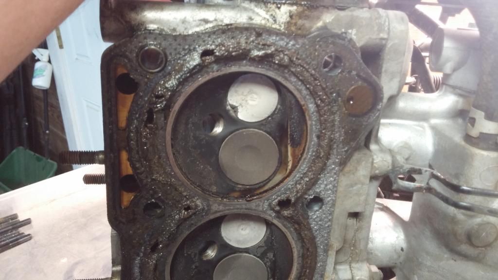

Took a little over an hour to pull the head. You guys were right, these things are easy to work on. I haven't had an engine that I could easily turn the crank by hand. The head bolts were very tight. But once I had them off, the head just came loose. I bet I can reuse that gasket, it just fell off, no damage.
wanderingturtle
And yes, I am gonna do the rings, too. But probably not rod bearings, since I read on here that it's hard to get the right clearances, anyway. On the head, do I need to replace valve guides too? Or can I just replace the valves and valve seals? I searched but it wsa hard to find any info related specifically to valve guides.
