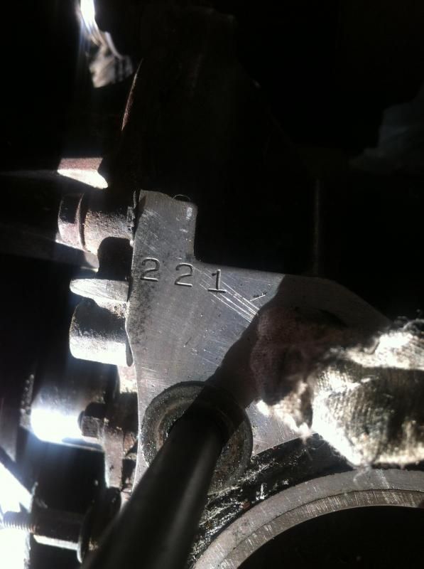

The more I though about it the more I wanted to pull the engine and look deeper. I just read about the pistons being numbered and the block stamped with the piston numbers.
The block is stamped 221 and it has 111 pistons so I already know the motor has been worked on. That makes me uncertain, I have a hard time trusting other peoples work if I don't know who done it, so I decided to pull it.

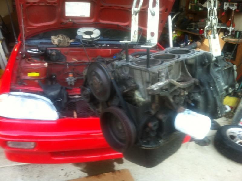

I get the motor out and find it has a 5 bolt crank pulley. I assume they previous owner either swapped pulleys or a newer motor.
The previous owner did spend some time and money on the car. When I was pulling the axles to pull the engine and transmission that I noticed it had new breaks, rotors, axels, and lower control arms. Also inspected the horns and they are solid. The car also has a new convertible top, swift tail lights, new exhaust, wheels and tires.
I'm guessing they spent all the time and money and the head gasket blew after it was just replaced and decided they had spent enough on the car.
I ran out of daylight so all I got done was pull the engine and transmission. I will get the oil pan off soon and see how the bottom end looks. Pull a main cap and inspect the bearing and journal. The cylinder still has cross hatch from being honed so I assume it has new rings.

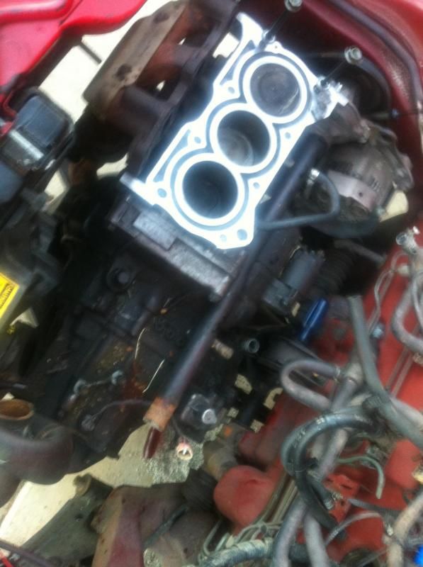

You can see the #2 piston is clean from the blown head gasket.

Those numbers are stamped in at the factory. After market pistons would have just an arrow and probably a number if it was bored over any.
If you can still see cross hatch that could be a good sign it isn't worn much. You need to measure the bores according to the FSM to make sure.

The pistons look like factory pistons. They have a arrow and the number on the top of the piston. The factory stamp is 221, the pistons are all 1 pistons.
I assume they had to replace the pistons and used factory pistons from another motor.

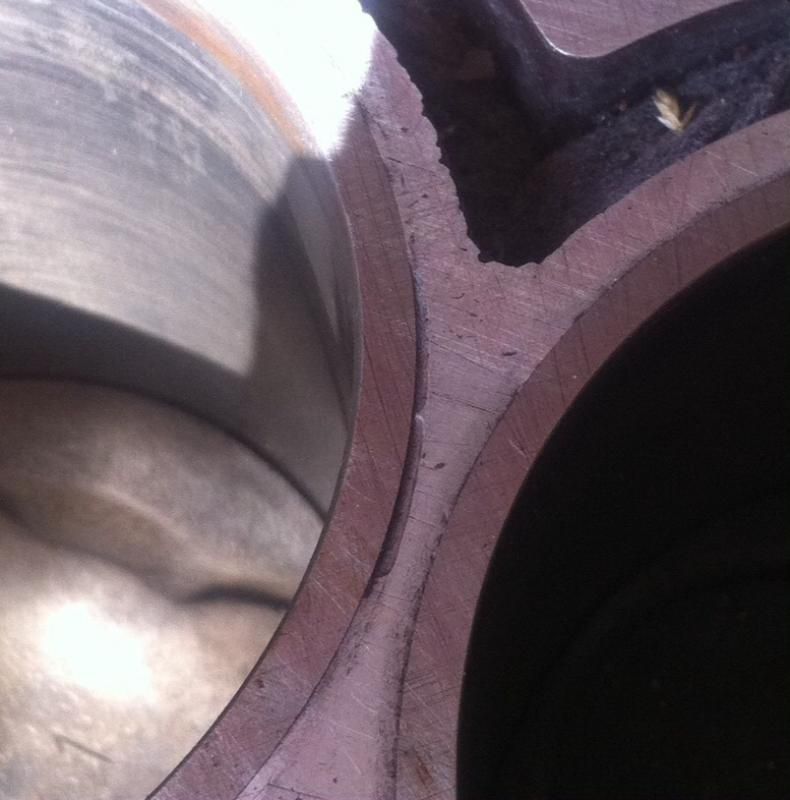

This does have me concerned though. It looks like erosion between the sleeve and block on #2 and some strange markings on the cylinder wall of #2

Before putting it back together make sure the top of the block and head surfaces get checked for flatness.
Head surface is .002" for flatness according to my 97 FSM. Might be different for yours but a good place to start . I would think the block would be the same for flatness.
The # 1 on the block indicates the cylinder bore size to be between 2.9138" - 2.9142"
The # 2 on the block indicates the cylinder bore size to be between 2.9134" - 2.9138"
The # 1 on the piston indicates that the piston diameter is 2.9126" - 2.9130"
The above numbers came from a 97 FSM and may be different for a 91. Please verify those numbers to be correct for you.

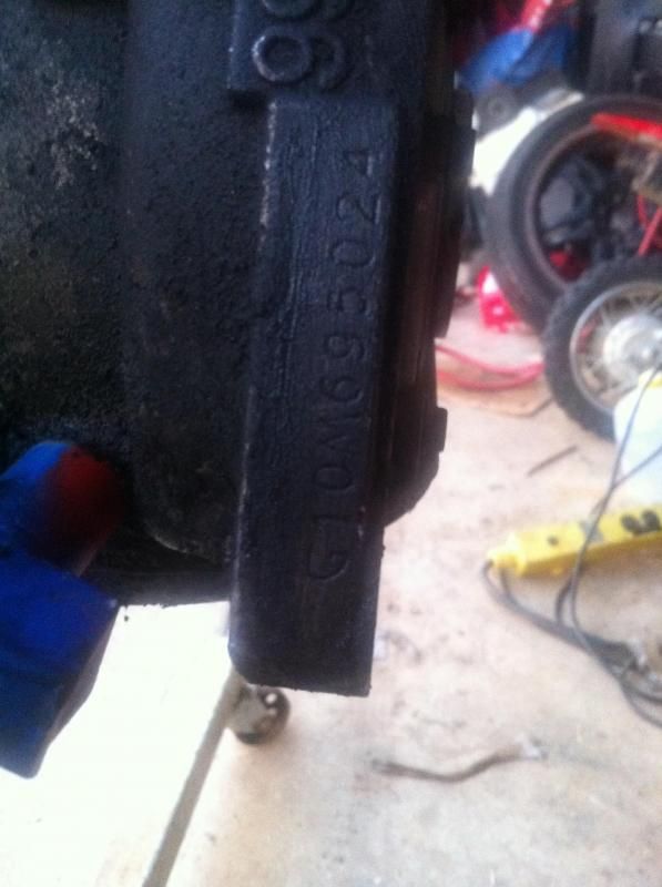

Have you checked the number stamped into the block to see if it is a engine from a different year? Numbers should be near the trans area and start with a letter. That letter should be the 10 digit of the vin. If they match then it should be a 91.

The engine number is on the parting line between the engine and transmission, below the large 993 CC that's cast into the block. "M" would indicate a '91 block, but really won't tell you a thing about any other component in it. For example, my engine has the original crank and rods in the block, and everything else is new or refurbished from a different engine, from the oil pump to the oil filler cap!
Well it looks as if it is a 91 block. I had to scrape a 1/8" of oil and dirt away to find it.

Yeah, I felt like an archaeologist excavating down to my number, too!!
