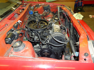

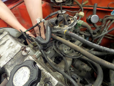

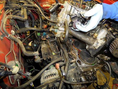

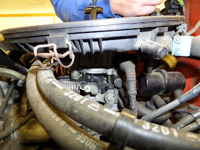

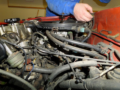

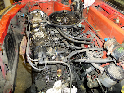

Removing the throttle body and head? All those hoses and wires!

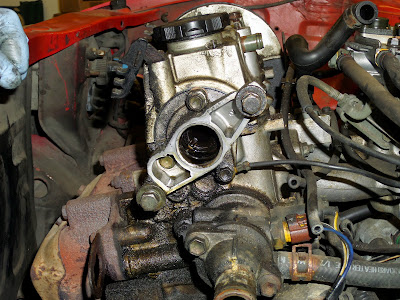

This valve cover did NOT want to come off.
Disconnect all the things!
Hoses, wires, tubes. All important!

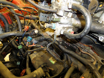

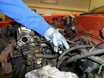

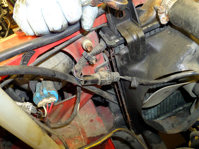

Goes to this plug which plugs into this one. This is important!
This little black wire...
Memorize all the hoses and wires!!
Radiator is out, maybe?

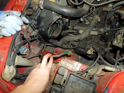

We labelled some wires. Mostly ones I already knew what they were for. Ah well.
Different lighting to show detail.
Closer from the other side.

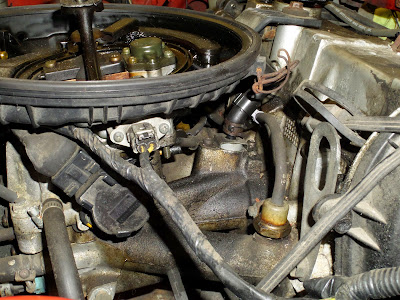

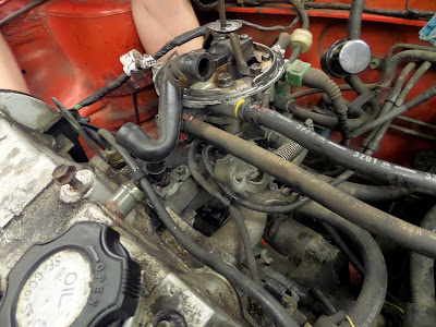

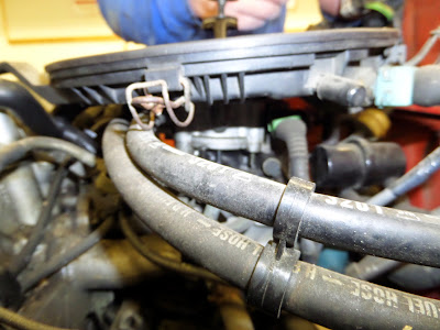

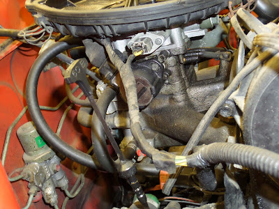

Hoses and wires. under the air filter.
And more.
More details of wires

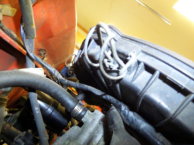

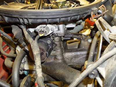

These wires go into the intake guy.
Map sensor wire. This is important. Leaving it unplugged for months makes the car run funny.
And remember where all this stuff goes!
"Don't forget where these wires go!"

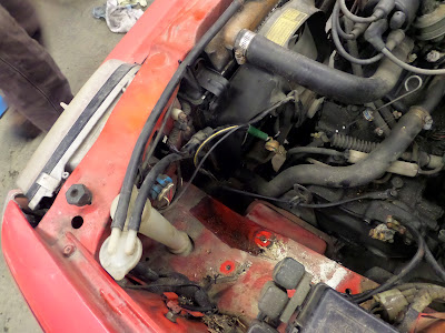

Battery, battery holder and coolant resevoir removed.

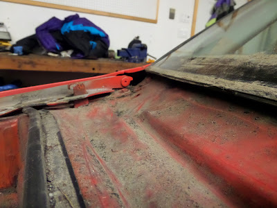

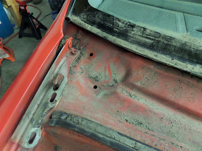

Hinge and dirt.
From above.

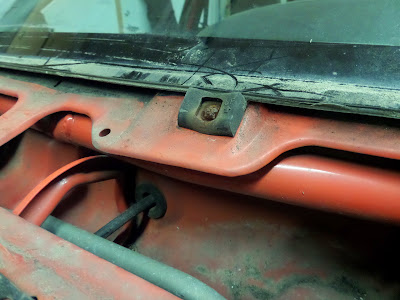

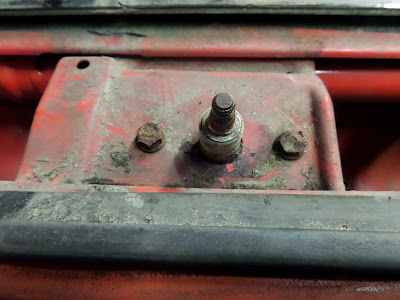

Passenger side hood hinge area.. I pulled off this rubber seal thing shortly after this pic.
Hood hinges. Also, dirty!

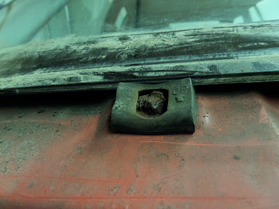

Couple more pics of the little screw windshield thingies.

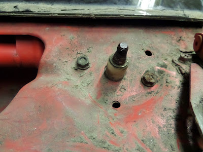

The pass side wiper holder.

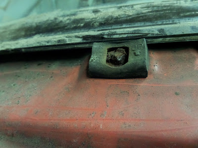

I don't know what these little clip/screw things are. Windshield holding stuff?

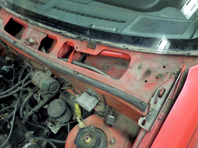

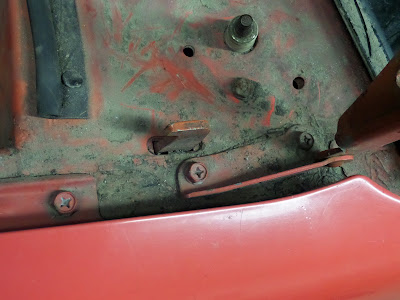

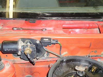

Windshield wiper mounting spot, Driver's side

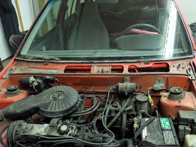

I pulled the louvres off and the windshield wipers, to clean in there. There was all manner of wet and oily gunk.

So I pulled the drivers side fender off and there is a true rust hole under there :( how do I know if the area is 'structural' in the 'bondo repair isn't safe' sense?
Have pics but need to upload from my laptop or something. Phone won't do the forum photos
Basically all non-body skin is structural. :smackface Question is, how structural? :hmm I'll wait for a picture to take a better look. :news One can actually "get away" with more than you think. ;) Great project. :cheers
