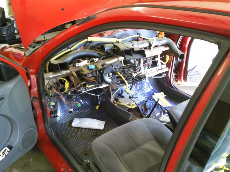

dayle1960 said "Can somebody throw me a bone? :coffee " not instill the fear of God in him. :rofl
Cobrajet25
Sep 1 2014, 04:11 PM
Cobrajet25
Sep 1 2014, 03:49 AM
It ain't as bad as it looks...honest! :cheers

YOU GUYS ARE LIARS!!!!!!!!!
My dash removal aftermath does not look anything like that. Good Lord what an experience.
I did the Mullet route and still had a couple of problems. Called Stiffcheeze and still had problems. Only took me five hours to pull it out.
How about the hidden screw behing the passenger air bak which is connected to the bazooka tube?
Who about the fact the A/C tubes are connected to the bazooka tube with screws which can only be unscrewed using a double jointed wrist? Just a real pain.
I will give props to Stiffcheeze because he took the time to explain some of the finer points in removing the bazooka tube. I really didn't like that option because it required unfastening the wiring loom from the bazooka tube. I will be waiting for his write-up.
I will say this: I had an easier time changing out the timing belt on my '05 honda Odyssey than removing the dash from my metro.
I am not a happy camper right now. Take what I spew with a grain of salt. It's just frustration bubbling to the surface. :banghead

If you took out the bazooka tube, that was your mistake. It does not need to come out...at all.
Why were you removing it? "Dash cancer"? Replacing the heater core?
