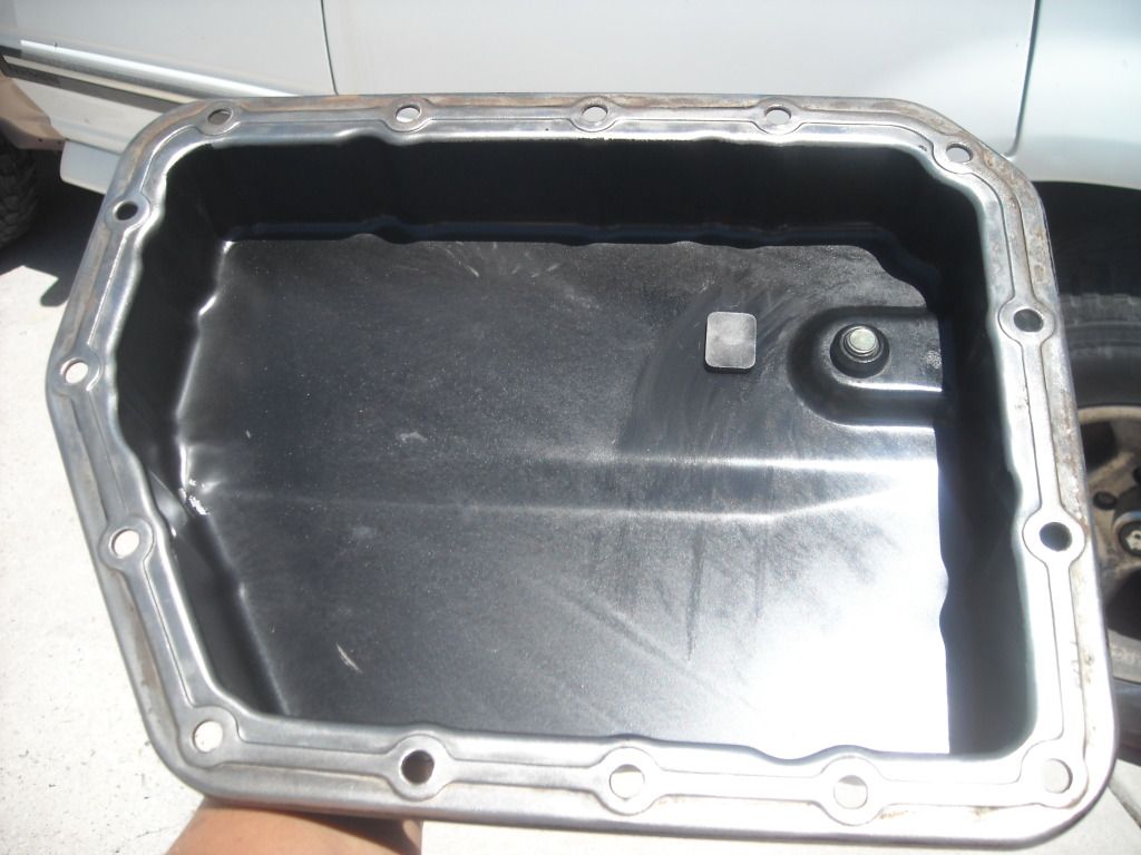

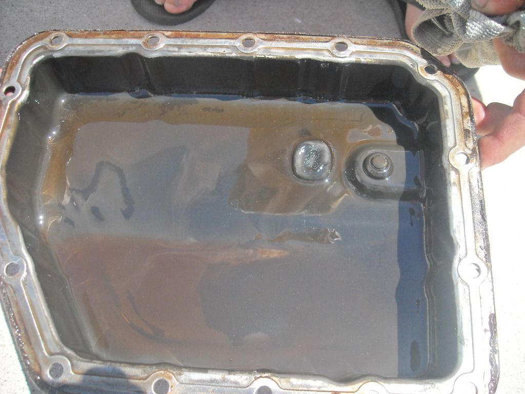

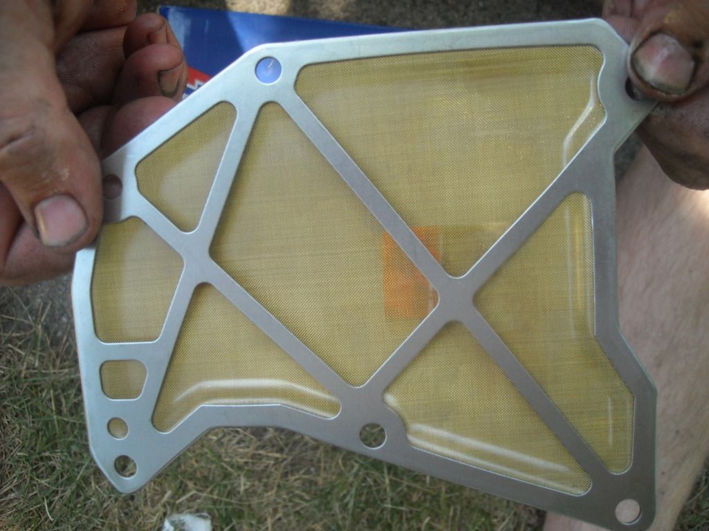

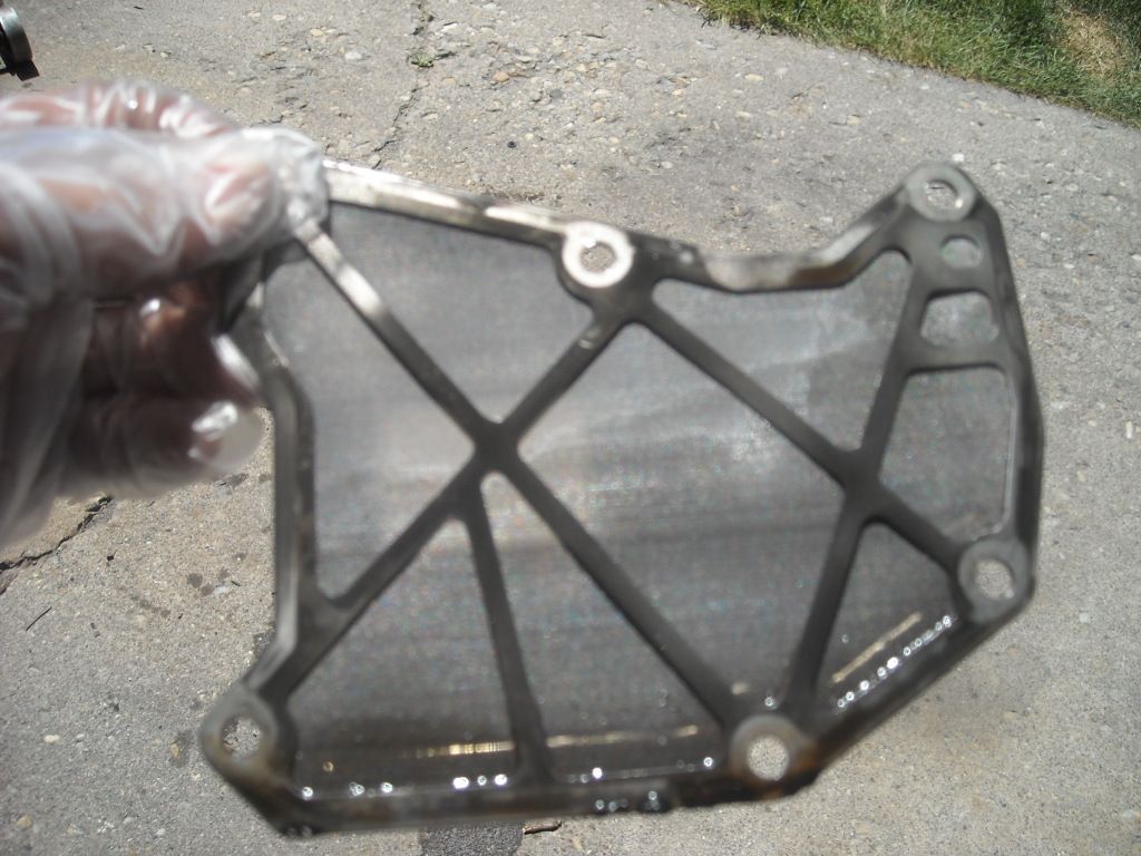

Aha! Knew I had seen some relevant pictures...
From econboxxxer's thread about "Meatloaf"...
http://geometroforum.com/single/?p=663993&t=4723202
econboxxxer
Jul 1 2012, 12:39 AM
Serviced the transmission today. New trans filter and Dex/merc fluid- since that is what replaced Dextron II.
Drove the car 300 miles today. Its getting ready for an oil change.
Running the A/C, and driving normal around town combined city/highway mileage was 36.2 miles per gallon. The highway miles varied from 55 to 75 mph- with more on the 60-65 range.
It was a good time to service the transmission.
The fluid was in good condition when it was drained, and there were no off smells. Servicing a trans at home is much more cost effective than taking it in to the shop to have it done.
Have a log book of repairs that will go with the car to whomever buys it. The brakes appear to be in good working order- the cv axles are good, and the shocks are in decent condition. The ride is fairly quiet inside- quieter than any of the Metros I have owned.

Wow looks like it can be a lot worse than it looks from up top. I'll order a filter too, then.
