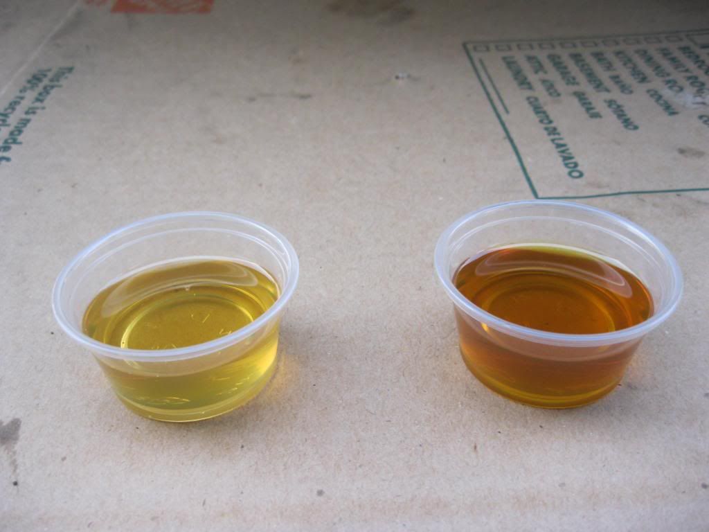

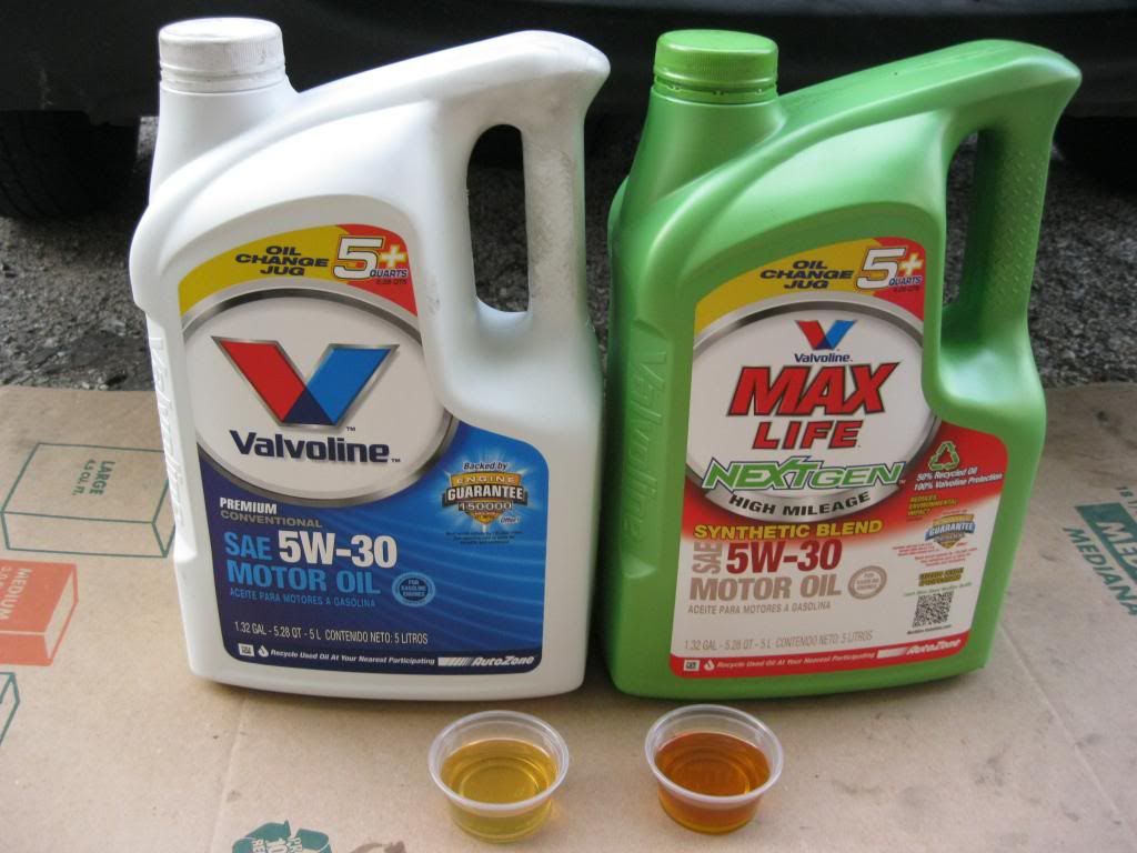

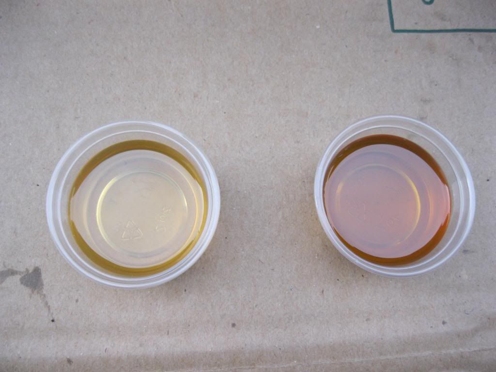

LeoGeo
Two new bottles, two new clean cups:
cwatkin
Looks like the additives are different. I have seen oils darker than others out of the bottle before.
