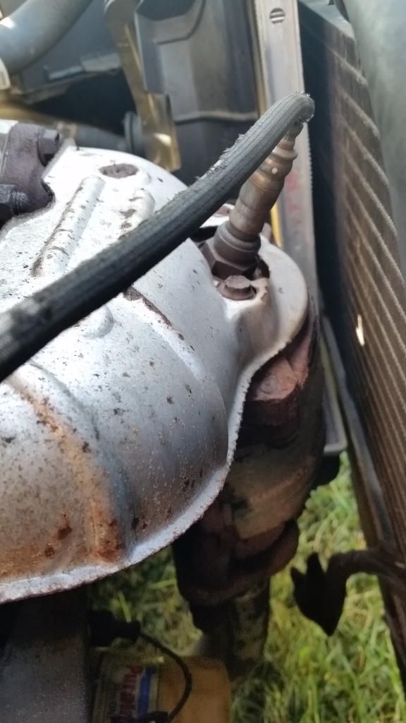

| Challengerguy | Sep 15 2014, 09:38 AM Post #4 |
[IMG][URL=http://s1184.photobucket.com/user/P-47DD/media/Mobile%20Uploads/20140915_103040.jpg.html] [/URL][/IMG]

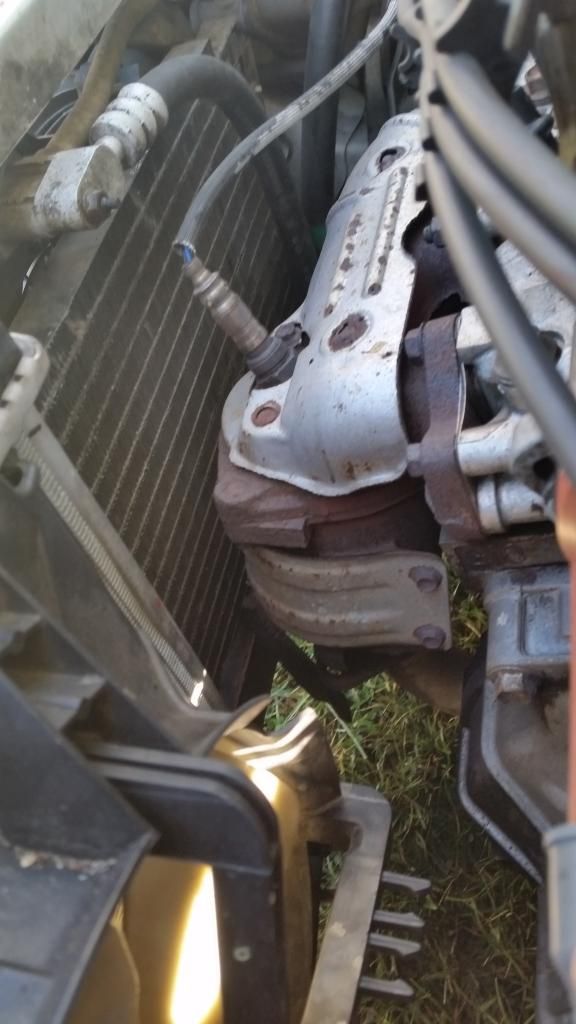

| Challengerguy | Sep 15 2014, 09:39 AM Post #5 |
[IMG][URL=http://s1184.photobucket.com/user/P-47DD/media/Mobile%20Uploads/20140915_103023.jpg.html] [/URL][/IMG]
| Challengerguy | Sep 15 2014, 09:40 AM Post #6 |
[IMG][URL=http://s1184.photobucket.com/user/P-47DD/media/Mobile%20Uploads/20140915_102955.jpg.html] [/URL][/IMG]
| Challengerguy | Sep 15 2014, 09:45 AM Post #7 |
What ever it is it need to go the 2 studs at the bottom are broken and it is causing a massive exhaust leak I can't deal with it any longer. If this is Cally emissions can I just buy the regular manifold. Will it fit I'm assuming I will also have to buy a computer that does not recognize California emissions? |

If I remember correctly, there was no actual difference in the fuel economy between the two different emissions systems. If you live in California it's illegal to remove that cat by the way. |
| econoboxer | Sep 15 2014, 08:39 PM Post #13 |
I am the one on the left.
remove- drill out broken bolts, buy new bolts, as well as a new exhaust donut- then reinstall. a pita for sure- but doable. |
