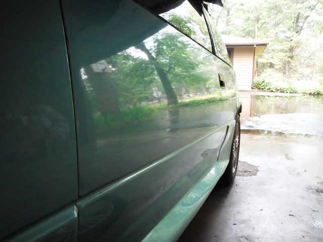

The questions just keep coming.... Something I've never tried is paint buffing. I was going to plan on a repaint down the line, but Justahoby mentioned buffing so I thought I'd investigate. Except for the fading, the paint is really in good shape with no rust, big dings, or missing paint. When it's wet with rain it shows its potential.
Is there any other way to evaluate the potential for buffing other than to do it? I know that it is very easy to wreck a paint job with a buffer and I hesitate to learn on a car that probably only has one chance to be buffed after spending most of its life in paint-fading AZ. turbogts22 is the closest member I would trust with a buffer and I could might be able to hire him to do it, but he is 3 hours away and pretty busy, although it would be worth my piece of mind to have an expert like him do it. ^o)

do it by hand- those variable speed buffers aren't for novices- you can burn a section easily because its so thin.
that car is beautiful.
I agree. ^o) Do it by hand, little by little, until you like how it looks. Lot's of elbow grease. :gamerz Plan on about 4 hours, start to finish. :hmm

i concur on the hand buffing and waxing.
just remember, "wax on.....wax off." ;)
i concur on the hand buffing and waxing..
:+1 on the hand job recommendation. :lol
It's always best to get someone else who has already learned how fast you can burn through old paint than for you to learn it on your own with your own cars, especially your new pride and joy . Besides, you can always get it buffed later if you aren't happy with your results, or you have a different Metro with similar (red) paint you can practice on before attacking your new Vert that you deservedly have big plans for.
:gp i bet a little elbow by hand would do wonders...

While I agree hand buffing is the safest option, I don't feel that machine buffing is something to be intimidated by. I have buffed many cars over the years and never once had a burn through issue. The main thing is to not start with a super aggressive compound. Also use light pressure, especially near edges and keep the machine moving. I just use an cheapy Black & Decker 2-speed electric buffer with either a wool or foam pad. Works great and saves a ton of time!

Once again the Geo Village responds to a question with a comprehensive answer that has actually been proven in the real world. Hand buffing is a method where I could feel in real control of the process rather than trying to wrassle a buffer with a mind of its own.... :x
