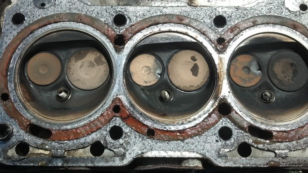

Col. Potter
Welcome back man Do the headgasket. Yes you can leave the intake in the car (easier than unplugging all that crap IMO) And while you are in their clean the egr passages out, clean the piston tops off and check your valves If they look anything like this replace them
