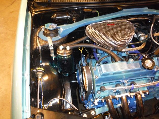

When I was having some cam journal situations, I installed this as a temporary "get me by until I can fix it right" set up.![]() Here's another set up, showing the T-Fitting so the PCV pulses are retained. ![]() Since the catch can is semi-transparent, one can see the condensed vapors. Canister has filtering media (stainless scotch-brite) to aid in vapor condensing.Since it appears that you are pretty set on pursuing, this type of a thing, PM me and I'll send as much stuff as I can find. You can have it all free. I may even have the strut mounting bracket, someplace, too. All that I expect is a gratuity to help cover some of the costs. If you don't, no problem. I'll just never send you anything for free again. And promise you'll be careful with the winter frozen catch can warnings.
