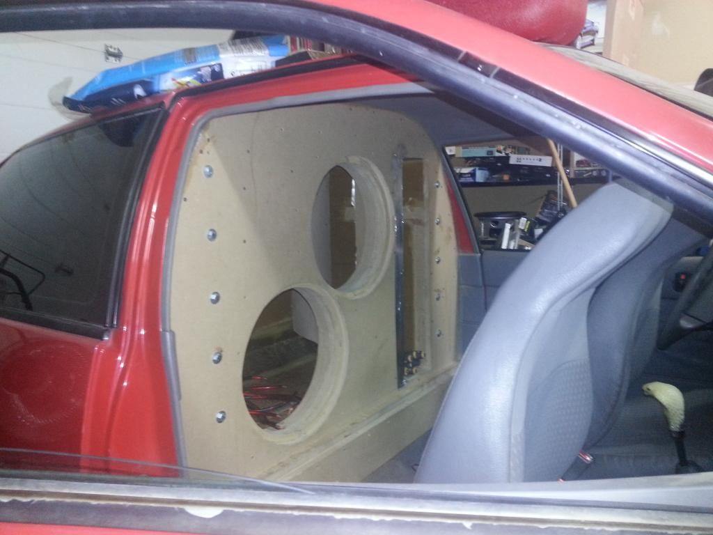

putting a wall of 15" subwoofers and 15000 watts

I started this a year ago and now its currently being rebuilt.
banginmetro64
looking good. what alternators do you have installed? what batteries? what is it tuned to? spl or daily?
akadj
Its tuned to 55/60 hz, just for SPL it can do a 155db. I have a XS Power D3100 under the hood and three in the back but I don't know what kind they are. They look like the Odyssey 2150 or DieHard Platinum

looks awesome. stetsom amps are beast amps. are those the toolmaker dual 1/0 inputs? have you upgraded the alternator? if so, what to? any pics of inside the box?

akadj
Yes they are toolmakers dual 1/0
I had the alternator upgraded and rebuilt to charge at 15.3 volts with 120 amps.. No where near the amount of current these amps draw (roughly 1000 amps each) but the extra batteries help for a while and then they are low 10 volts after around a minute but that's all I need for competition

why not consider 2 inch silver plated copper bus bars for the current network ? we used that in the telecom manufacturing industry / AC-DC 48V power supplies
akadj
I would have loved to, but during the build I was trying to go the cheapest route, all the 1/0 and 2/0 wire was free, I only paid 300$ for the woofers, I actually traded some kid from a small farm town in Alberta straight across 1998 Panasonic CD player (which I got from a friend for free when he sold his car to an auto wrecker) for the Geometro it self.

+1 on the bus bar, if there is room. If you could shorten your runs and double them up that would help too. Can you twist the batteries 90 degrees and have room for a 4th one? Then make short jumpers to the + side and - side.
