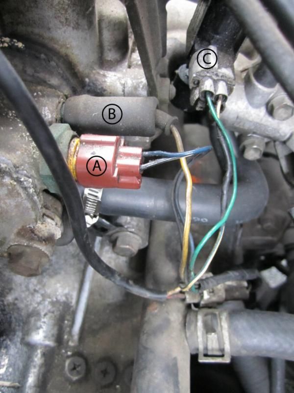

hi, I am wondering if anyone can help me. I have a '94 geo metro 1.0L base model hatchback with standard transmission. My radiator fan however does not work, in fact it never has (since I have owned the vehicle). I have checked all the fuses, they're all good. The tempurature gauge in the car works as it should too. I have checked the fan motor by hooking it up to a nine volt battery and it works. My hanes workshop manual says the next thing to check is the cooling fan tempurature switch, as I suspect that maybe where the fault lies. However I am having a little trouble identifying and locating the aforementioned switch. I suspect it may be connected to one of the electrical connectors I have marked in the attached photo, A, B or C. Please can someone help me? is it one of these? or all three? or am I wrong and its not even in the photo? I would really appreciate any help anyone could provide. I went to a local autoparts store, thinking I'll just get the part from them and then replace the matching part that was in the car, however the staff were unable to determine which one to get as several options are available on their system all at varying prices, so I didn't know which one to get. Thanks [IMG][URL=http://s74.photobucket.com/user/oldskewl99/media/engine_001.jpg.html] [/URL][/IMG]
| DieselGeo | Dec 18 2014, 11:13 PM Post #2 |
the fan switch is what you labeled "A" |
