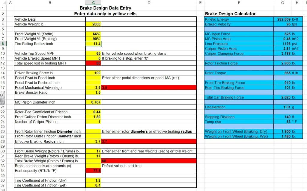

I entered the information for my Metro into my Braking Force Calculator, and assumed 80 & 90% load on front axle during hard braking. I think the calculations are generous in over-stating the results, but ya' gotta start somewhere!
Here is 80%.
Here is 90%.
The difference between 80 and 90 % shows up in the weight on the rear. The front brakes generate only the maximum force they can according to the design of the braking system, but if we assume 90% (which, based on this, I don't think we can physically reach) the rear tires are getting really light. The braking force on the front tires exceeds the traction available, and even at 80% they are sliding on dry pavement, reducing the real-world (as opposed to calculated) braking force by roughly 15%. The Metro appears to be traction-limited.
80% weight on the front axle under maximal braking gives you more total vehicle braking force, more deceleration, and a shorter stopping distance than 90%. Think of how much braking force a motorcycle rider gives up when he does a "stoppie" and his rear wheel is off the ground. Looking at the weight on the rear axle, that's where this is going. I did some simulation at lower front axle loads, and as more weight was left on the rear axle under hard braking, performance just kept getting better and better. The more braking force the rears are providing, the higher the deceleration forces and the shorter the stopping distances.
The Metro is limited by the traction available at the rear axle. Having poorer, worn tires on the rear axle reduces rear traction, increasing stopping distances and reducing total vehicle braking forces. There is no problem with front traction. The problem's at the rear. Putting the newer tires on the axle that needs them just makes a lot of sense to me, and I have good data to back me up.
Once you can lock the front brakes, that's it. Understeer city. Beefing up the brakes without going to high-performance rubber will only help you lock 'em up faster. Changing to better rubber without doing anything to the brakes will allow you to utilize more of the potential braking force, but only on the axle that needs the help.
