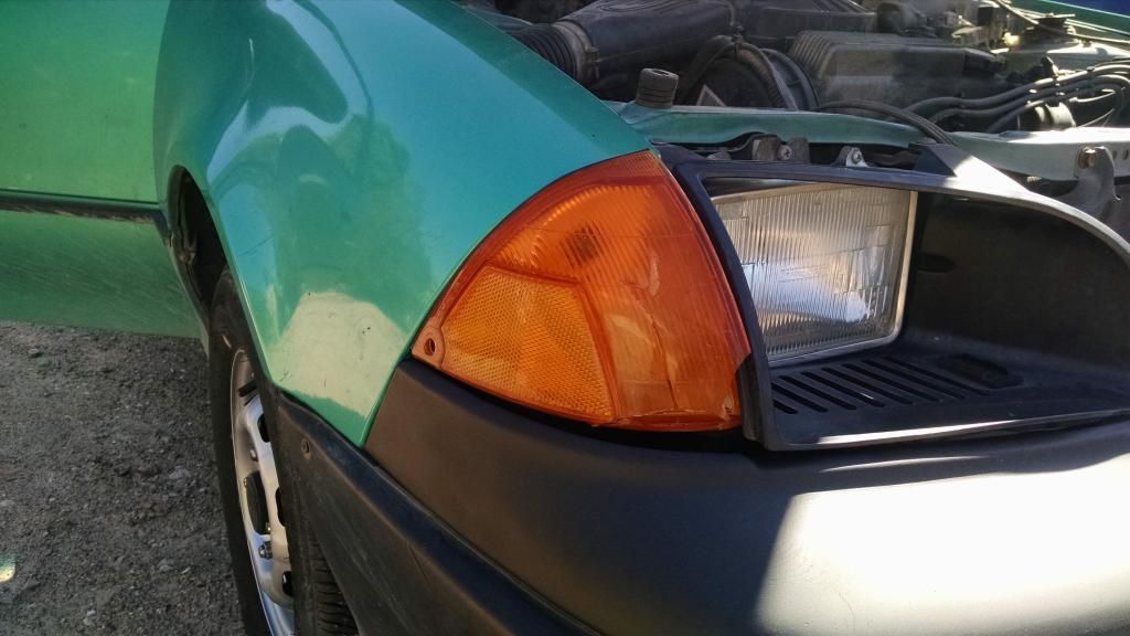

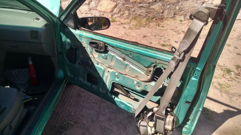

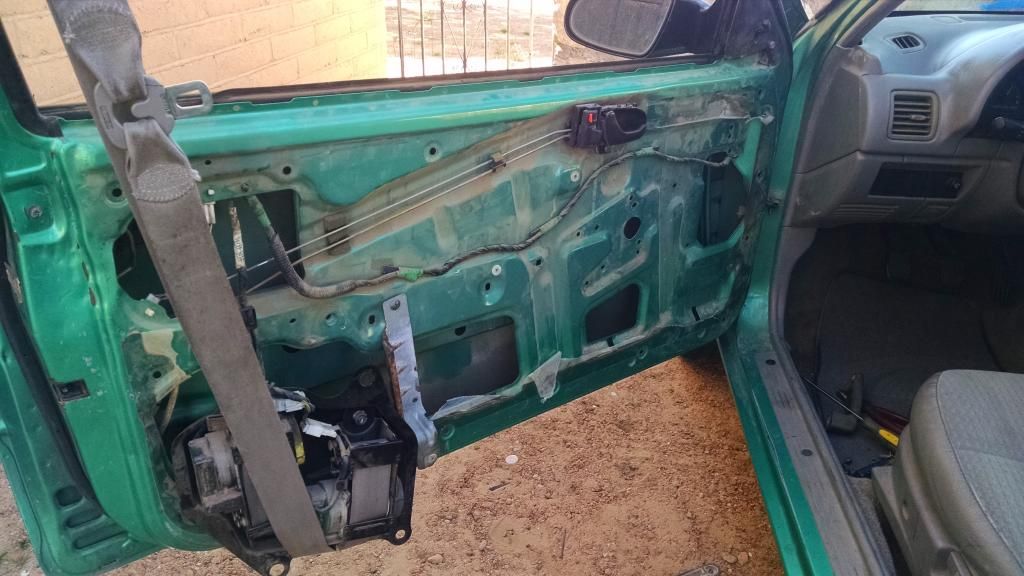

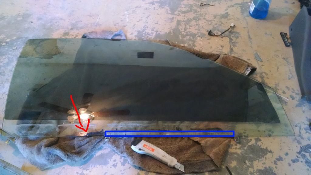

After waiting on a list of parts to arrive, they've come in! I replaced the busted passenger corner lens with a new one (thanks don_dowdy) and I installed the brand new regulator I bought for the passenger door since it was way too messed up to reuse. I was feeling confident until I got a look at some dickering done by the PO. Turns out the regulator that was in there was so f'd up that he actually had to remove the metal bar siliconed to the window and move it a few inches backward just so it would stay closed That means when I put the new regulator in there it didnt line up at all (the blue is where the support is currently glued and the red arrow is where it's supposed to be...) So I took the window to a local glass shop to have them redo it because I'm not going to be the idiot to break it I'll pick it up tomorrow hopefully in one piece![]() You can see the new regulator peeking out the bottom ![]() It would be nice if just ONCE someone didn't do something retarded to a metro...a dream I guess |
| idmetro | Feb 19 2015, 02:54 PM Post #17 |
The challenge is the price point. Vehicles that are significantly more expensive usually get someone with some skill level or who recognizes that they don't have the skill level to make a repair/modification so they hire it done (this does not mean there are no badly done things that happen, just that there are fewer). Metros are way down the value food chain and thus have to suffer from the "experimenters" who really shouldn't be touching anything... |

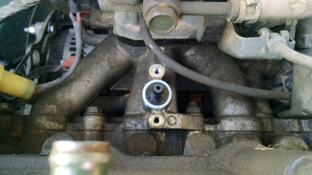

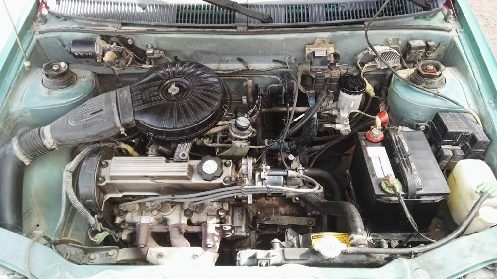

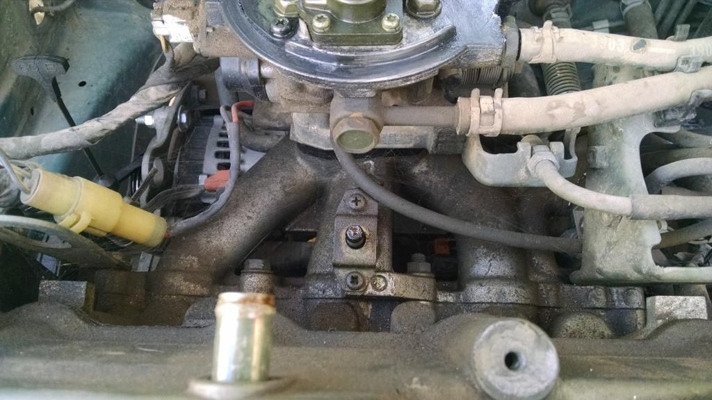

Today I focused mainly on the mechanical aspects of the car. The first thing I did was inspect the PCV valve which was 100% clogged and appeared to be original to the car so out that went in a hurry! Got a nice new shiny one put in there and cleaned the crap out of the tube going to and from it (also clogged). Found out that the car has a brand new air filter, new charcoal canister and lines, new battery, new clutch arm, new coolant hoses, recent coolant flush, recent brake fluid flush (crystal clear), a block heater, and to top it all off an apparent recent rebuild I looked at the cam and it sparkles like a diamond not to mention the pure honey colored oil (and every single gasket is new and rubbery) so someone either rebuilt this engine in the last year or knows the secret to keeping a metro flawless forever. Very strange and certainly not the work of the PO, which makes sense because he only had this car for a month so he said. This car does not leak even a drop of oil, I made sure of this by parking it over a large piece of butcher paper bricked to the ground and in the 2 weeks I've left it there I don't see even a drop of oil anywhere. This car is amazingly well cared for...mechanically at least. Here's the old PCV ![]() And a nice new one ![]() and an engine bay shot, pretty clean for being 21 years old! That's a block heater to the left (the cord wrapped around the radiator support) ![]() Edited by aaronvincent, Feb 21 2015, 02:43 PM.

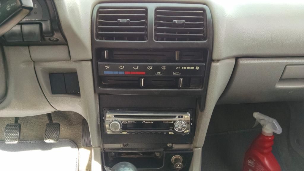

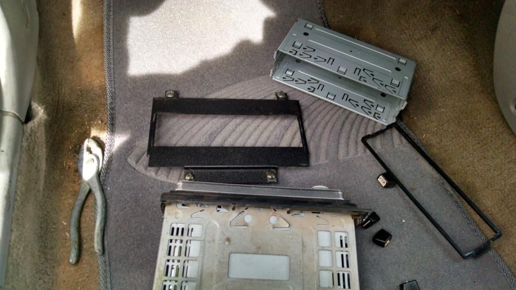

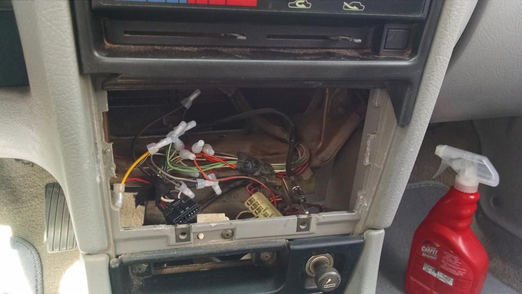

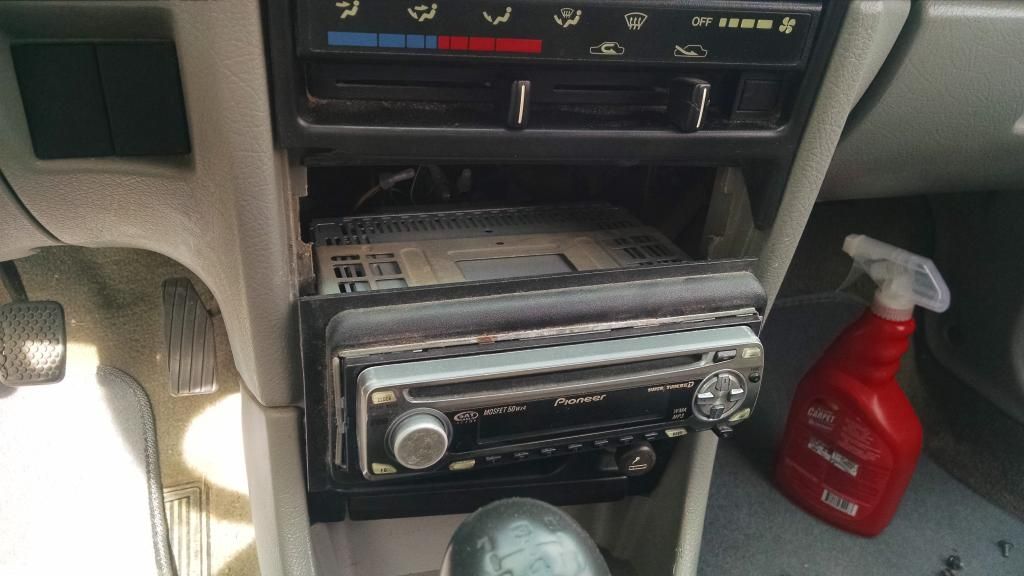

Due to a large delay at the window company I had to work on something else today. So I decided that nasty radio situation needed attending to. First I needed to find a proper cage/mount setup since the one that used to be there is currently MIA. A pm to member Mythstae (our resident radio persons) yielded me the exact parts I needed in barely a week and they got here super fast! I got to work quickly and the whole operation took maybe 35 minutes. Needed to clean up some wiring, reconnect the cigarette outlet (no wonder it didn't work) and slap it all back together. The only problem now is I need a new radio bezel because this one is This is going to be a quest...This is how my radio started...flaccid and un-aroused with audio pleasure ![]() Then I ripped it all apart and did a little bit of wiring (mostly soldering and reconnecting the cigarette outlet) ![]() Here's the parts Mythstae sent, all nice and strongly machined ![]() And finally here's the result, the way it should have been in the first place! Now just gotta find me a radio bezel (good luck)
| Mythstae | Feb 24 2015, 03:32 PM Post #20 |
Great job on the install, Aaron! It looks way better now!
