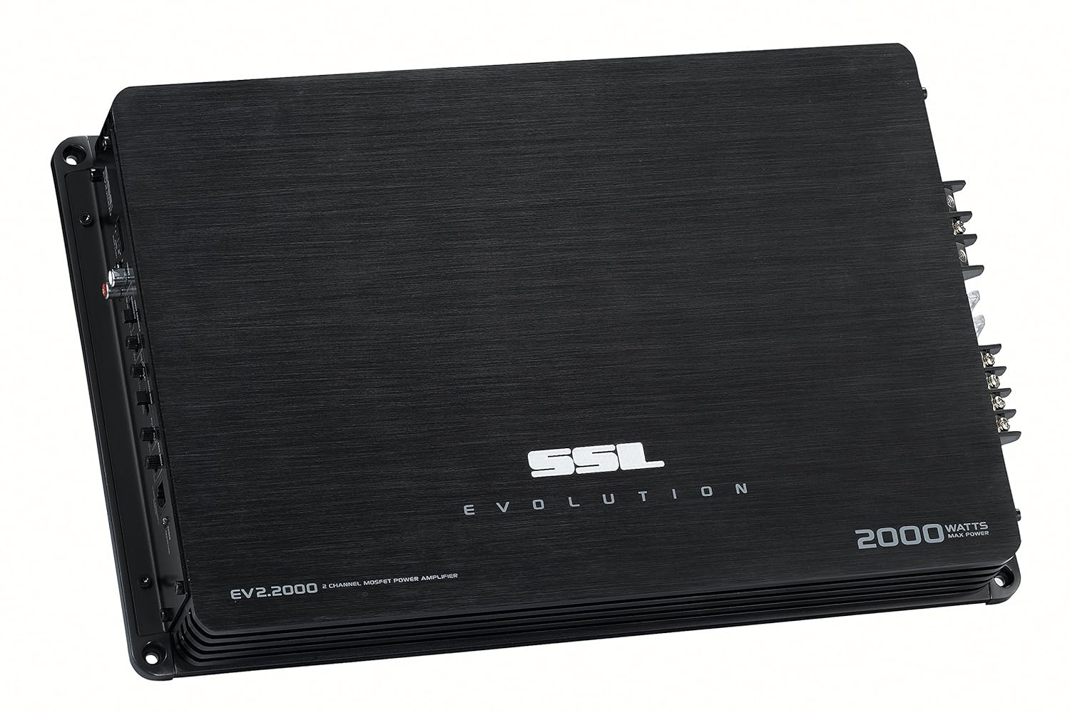

terry8750
terry8750
This is what amp I use for my mids and high on my metro.
there only like $100 on amazon
Edited by terry8750, Aug 23 2015, 04:38 PM.
