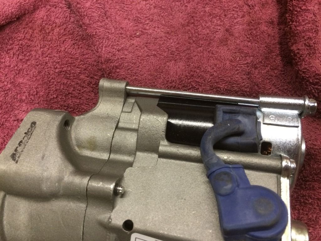

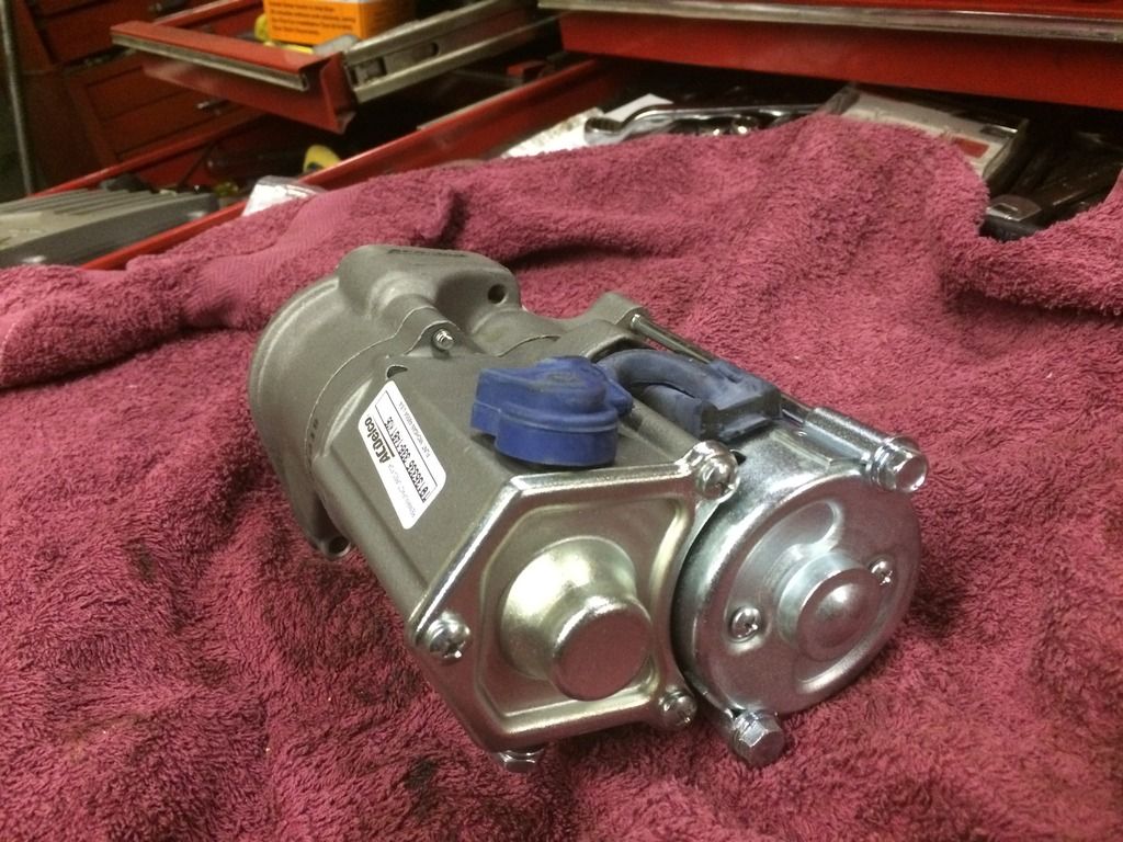

yep, you can't beat those old gear drive starters. it's a wonderful thing to find a new shiny one. ;)

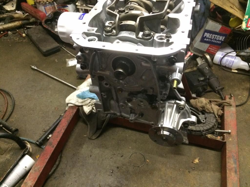

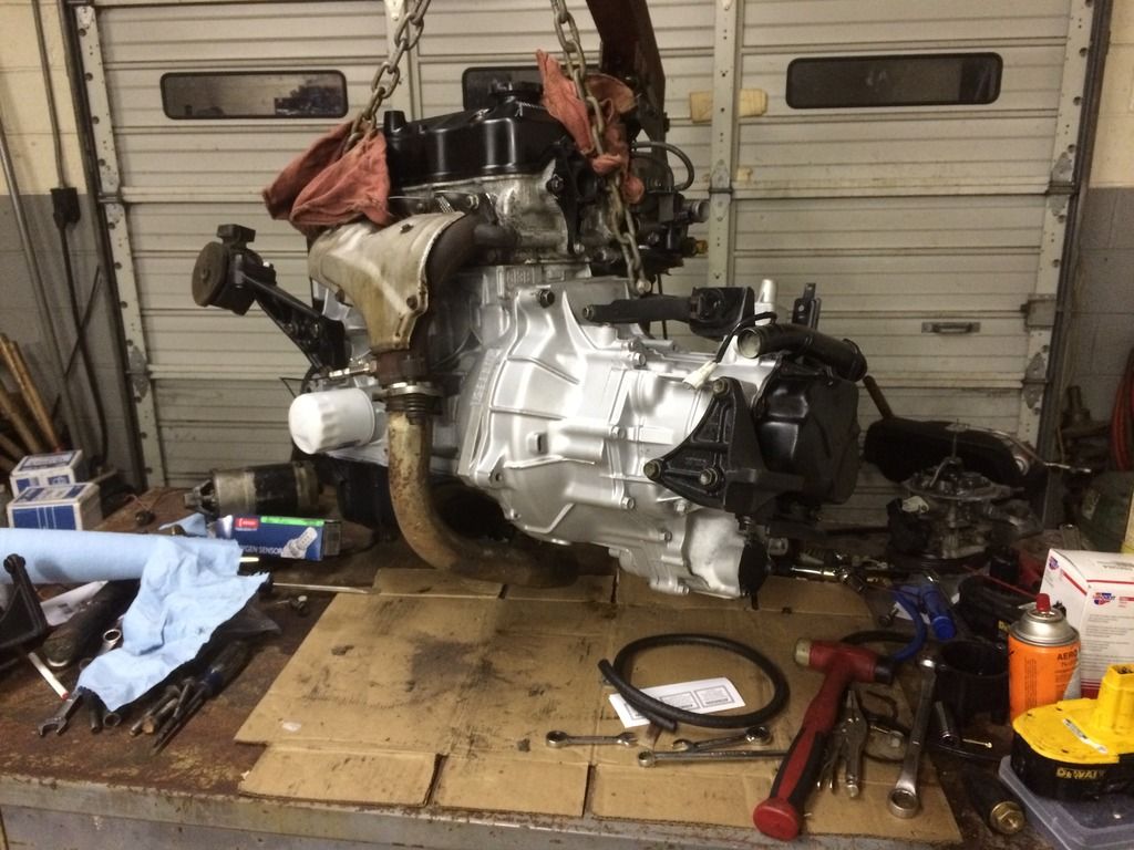

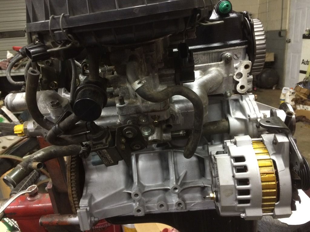

There is a table under the engine and transmission.
Hotrodray1
Over Educated parts guy

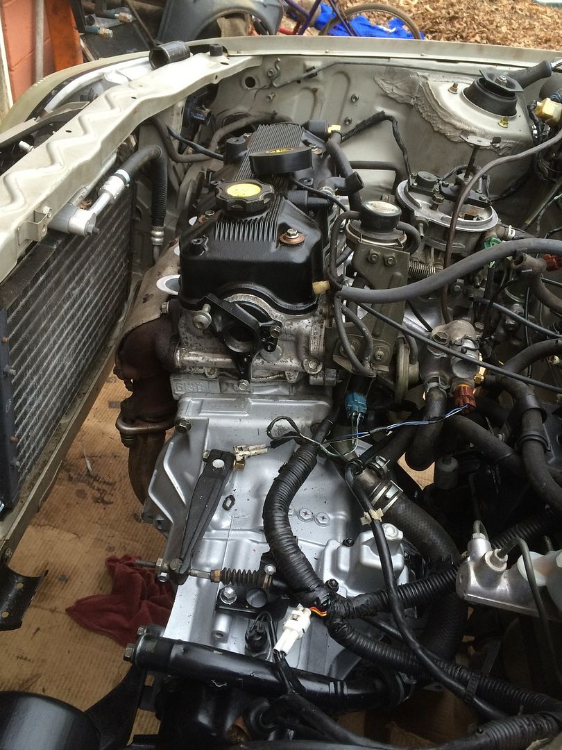

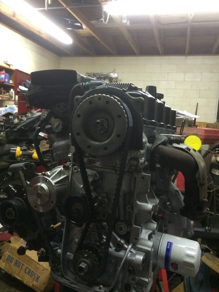

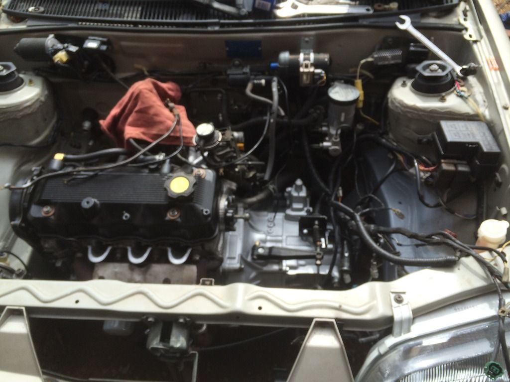

I spun it over oil pressure came right up. Put coil wire on and fired up on first turn. I will have to set Timing in the morning!
Stubby79
I'll have to look closer at my gear reduction starter...I don't recall it looking anything like that!

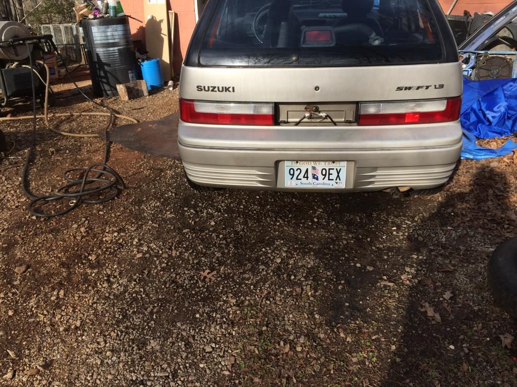

Thanks! Drove around a little this morning.fixed where some one had cut convertor off I have no ideas who that could have been!Then found 3 more holes in exhaust. My just patch till after Gotg. I am on vacation next week I and make a new exhaust system then.

Runs real good boy 2500 rpm at 60 is awesome! It don't like taking off on hills.But what can you expect out of a 3:52 gear.

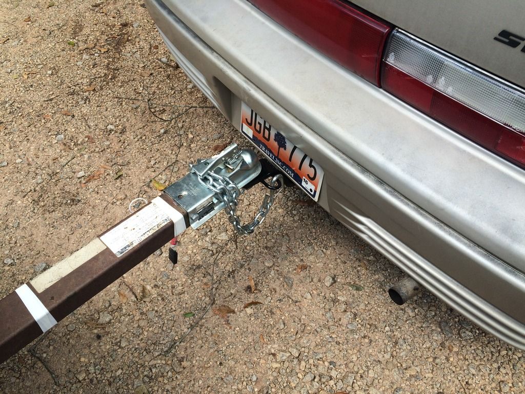

Nice! Ive always wanted a little trailer and a roof rack like that on my 5 door metro.
Hotrodray1
Well I got 37.5 mpg from my 1.3 swift with trailer in tow with air on round trip to Geoplooza and back. Not to bad running 70 most of the time. I went 1495.7 miles it used 39.8 gallon. With lots of down to 3rd and 4th gear changes with my 3:52 geared trans. I will have a 3:79 in it for the next meet in Fla for the spring I hope and see if I have a improvement in my mpg towing a trailer! Man I love my trailer!
