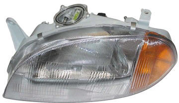

ok so i have a 1997 hatch i had gen 1 headlights
i ended up swapping them out for the 2nd gen ones
so right off the bat the plugs had to change, that got taken care of

where did you get the headlight assemblies from and how much? they look great

I can see a set of these being used as a projector retrofit with the smooth outer lenses. :news
i got them from ebay about $120 for the pair, they are from the 98-01 metros
