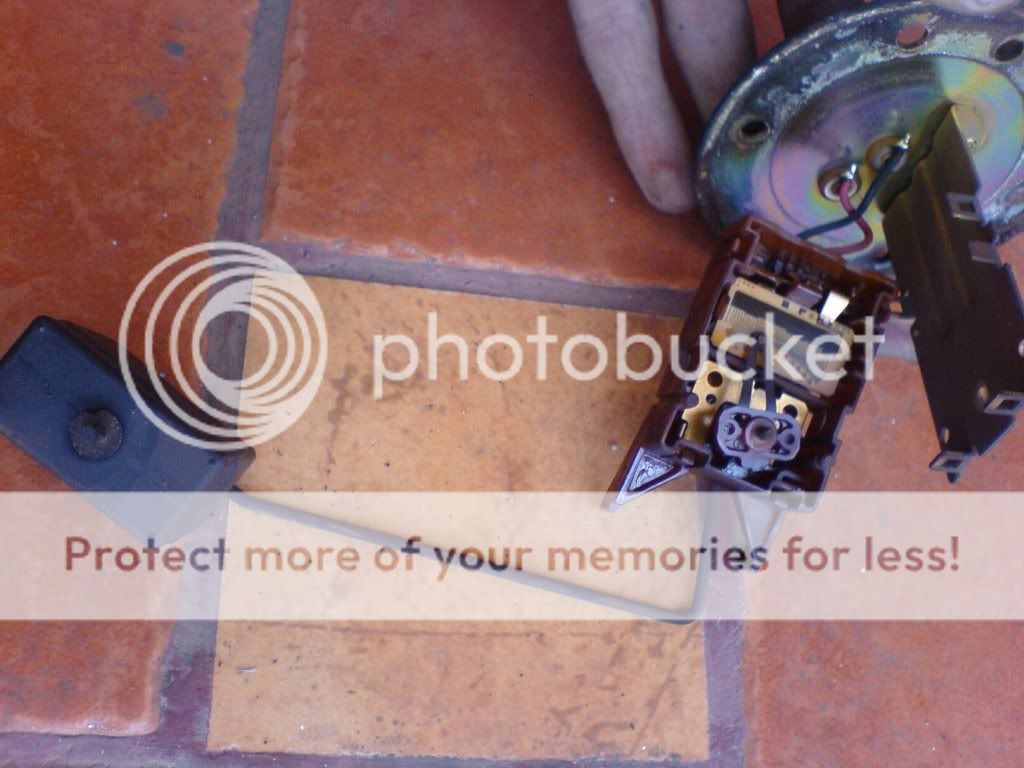

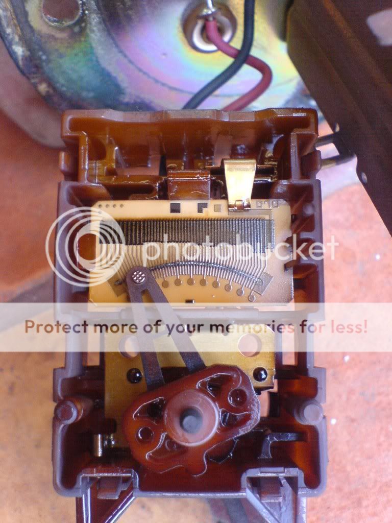

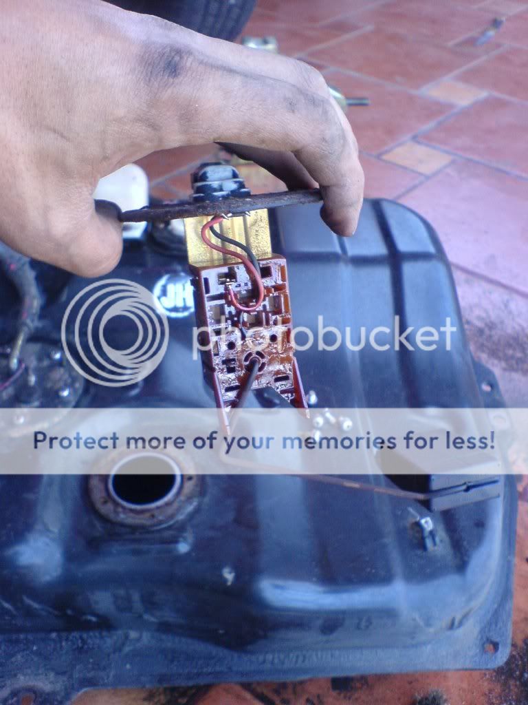

As the title states, my fuel gauge is acting all kinds of funky. When it decides to act up, it's very sporadic; it'll be a fuel tank and then quickly the needle will go all the way to the bottom and stay there for a while... (until one day it magically decides to act normal). I figured maybe it's time to change the sending unit and the pump (330k on the car...), but haven't been able to find a replacement for the sending unit... Do our cars have one or is it built into the pump or something? |
| Bad Bent | Mar 1 2015, 02:22 AM Post #2 |
Sending unit pics from How to change fuel pump - 95+ Metro; fuel gauge issue :![]() ![]() ![]() However you might want to check electrical connections under the hood and through the car, all the way back to the tank, before you drop the tank.
