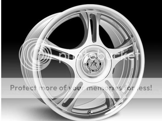

American Racing Wheels- "Estrella's" J5.5x13.
Offset unknown, but they were from a Dodge Colt.
I gotta take some measurements, the next time I have them off. That will be next rotation, in about three months.

Maybe 35mm offset, that what the chart I found listed.
