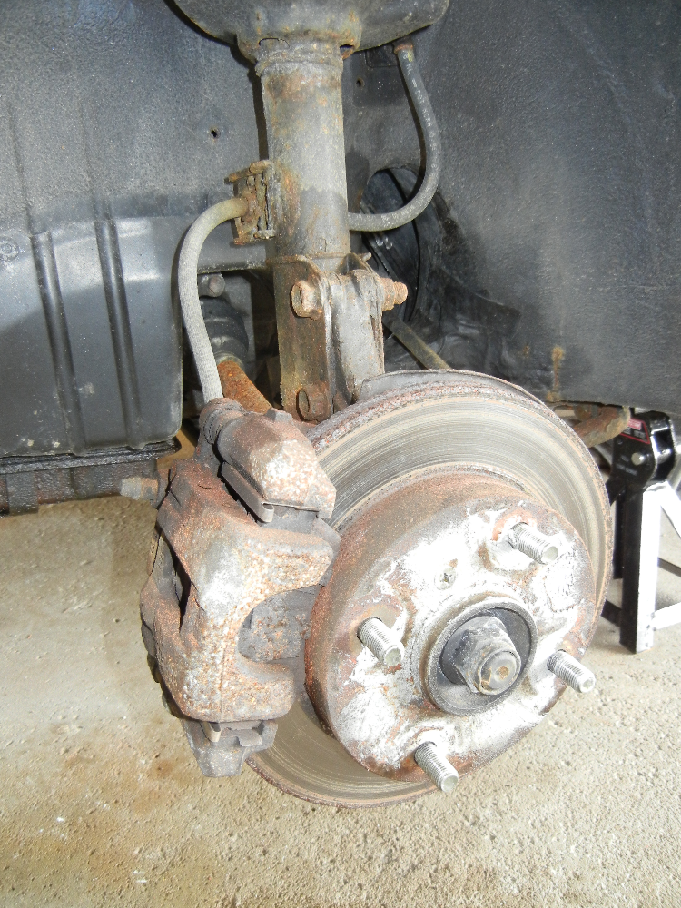

Driver side- before
Passenger side- before
OK, I managed to get the flexible brake line disconnected and was (eventually) able to remove the caliper and bracket from the driver side, but now I'm stuck. :banghead

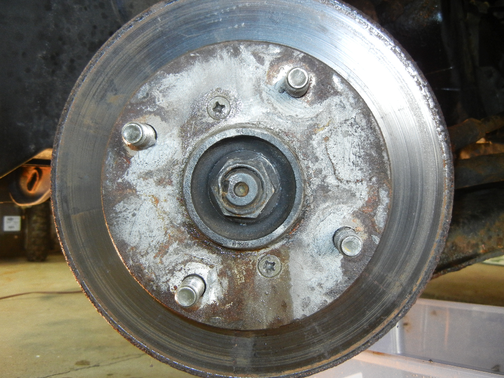

I can't get the Phillips screws out of the rotor. One of them looked a bit stripped before I even tried it. I also noticed that there aren't any bolt holes to help get these off so I guess I'm just going to have to beat on them until they loosen up?
Anyone have advice on removing these screws? Also I don't see any replacement screws with the new rotors so I guess I will need to find some new ones.
I just did the brakes on my 2000 and it turns out those screws don't do jack...so when you get them off you can toss them aside and leave them off. You need a phillips head that fits in the head perfectly with no wiggle room, I used a #3 phillips head on mine to prevent further stripping. You need to apply a generous amount of PB Blaster to the screws and let them sit for a few hours if not a day to loosen them up. When unscrewing put a good amount of force on the screwdriver to limit slippage and uneven contact. I had a hell of a time getting the caliper mounting bolts out, they were in there TIGHT. Had to soak them in blaster and tap them quite a few times to even get them to budge at all. Ended up stripping one of them :shake

I was hoping that there was some sort of "magic screwdriver" for this, but I guess I'm doing it right with the #3 + PB. :dunno
I'll definitely leave those off when I install the new rotors.
I haven't looked yet but I'm assuming there are torque specs for the caliper bolts. Luckily mine seem to be loosening w/o any huge issues. D/S are off and P/S are broken loose, but I'm leaving that side on for reference until I'm finished with the D/S.
Use a screwdriver that fits TIGHT, and one you can use a hammer on. Hold the screwdriver in place good and tight with a slight rotating pressure. Smack the screwdriver with a hammer just as you put excessive rotating pressure on the screwdriver.-----or-----
go buy a screwdriver designed to hit with a hammer and automatically rotate.
As a last resort, (my FIRST resort), use a 1/4 inch drill bit and drill the heads off. after the rotor is out of the way grind the bolts off smooth.
Edited by Old Man, Apr 11 2015, 02:04 PM.
There is a majik screwdriver, it's called an impact driver. I've heard it called a pit, but not lately, maybe that's an old timer's term.
Sometimes if you put a good quality screwdriver in there, put some anti-clockwise tension on it, and smack it with a hammer, it will jolt it free. Same idea as the impact driver without buying one.
Never seen a rotor without the extra screw holes for getting it off, hope that doesn't turn into an issue. I'd sure be hitting the inner diameter of the rotor with PBlaster while I'm figuring out how to get the phillips screws out.

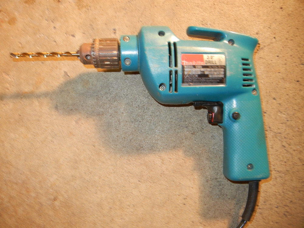

First, as many have suggested- this was the solution to the screws:
About 5 seconds per screw to drill out, then filed them flat.

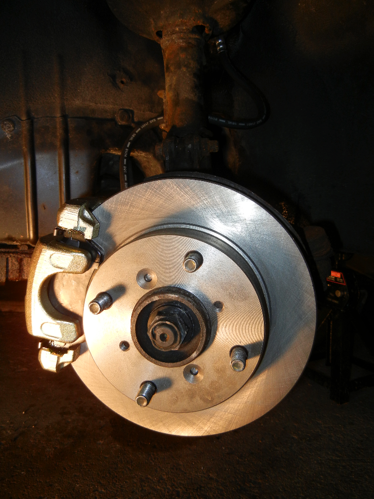

I had a lot going on yesterday so I finished up the driver side last night. a couple hours of work because I don't have the best tools and was being pretty methodical about everything.
Passenger side went pretty quick this morning and then about an hour to bleed all four lines. Drove it around for a bit to make sure everything is holding together. No leaks or squeaks so far; the fluid level is holding steady.
Thanks for the help everyone! :thumb :thumb :thumb
