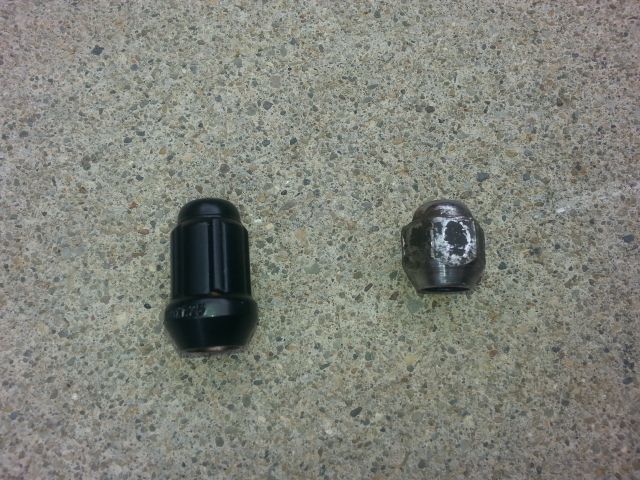

YIKES!! The stock nuts are so small the outer edges look like they barely hold anything on. To be safe, get the Gorilla bulge nuts.
Gorilla bulge nuts

"stock lugs" for 13 inch wheels are 12 mm.
please explain to me how you use 12mm stock lugs on a 10mm lug bolt.

Pretty sure they are using the "stock" 10mm lugnuts that came with the 12" wheels to hold the 13" wheels in place on the 12" hub. That is how the Metro I just picked up was set up...

Mine was set up that way, too. They threw the set of 12s in when I bought the car. The car had 13s on it with the original 10mm lugnuts. I didn't care for the looks of that, so I got a set of bulge nuts. I'm in the process of converting all hubs and brakes now (from a couple of '95s), as I have a really nice set of 14" alloys I want to use.
