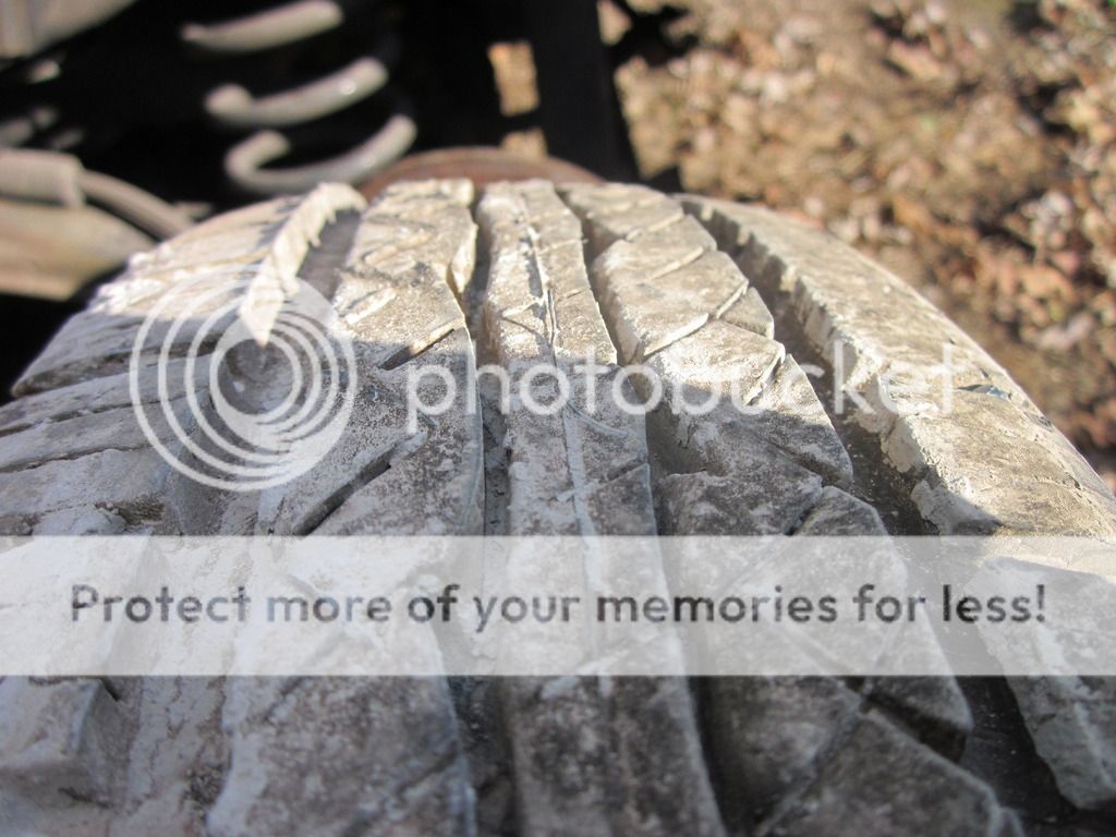

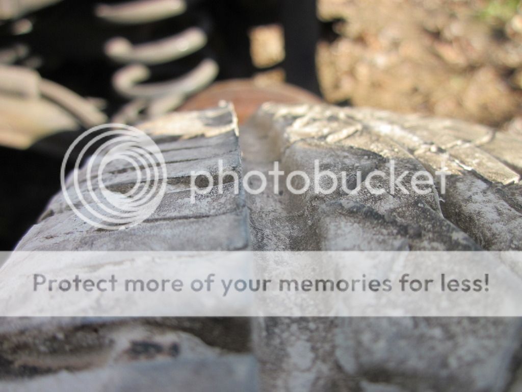

I went to pull a part today and seen a good set of tires and rims that fit a geo. The are probably a cheaper tire, (Solus made in china) and I took them off the car not looking real close the the thread. Once I got them off and look across the top of them if looked like a feathered edge. Wasn't terrible bad but still noticeable. They had lots of thread left and the side walls looked like new. I don't think they were on the car very long.
Would it be okay to put a tire like this on the back of the car or would it tend to have driveing issues?
I didn't buy them once I seen the thread wear but thought I would ask. The tire and rim is only $20 apeice.
"feathered" edge indicates out of alignment.
I would run them if I had to. Air up the tire till the 'feathered edge' does not contact the asphalt, maybe 40-45 psi
For $20 ea with rims, I'd go for it. Sounds like they had a toe adjustment issue. Bad tie rod or something.
The tire max pressure was either 44 or 45. That's were I run them at is the max. Maybe i need to go back and get them.
I looked up feather edge wear pattern and I think that was the problem. Toe in incorrect.

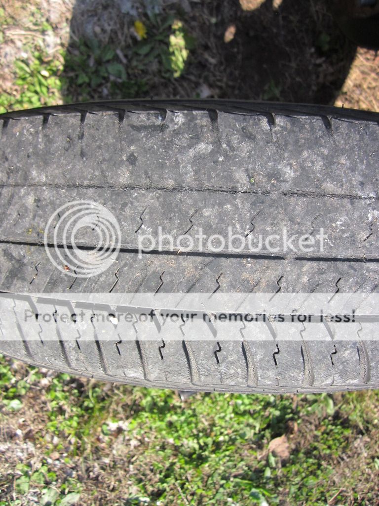

Went this weekend and got the tires. I put them on the back of my blue 96. Had to fix a bad bearing anyway so I figures it would be a good time to change the tires out.
I put the tires that came off the back onto the front. Looks like I need to do some front end alignment on the car. Tire wear is a little off.
Looks like it has to much camber right?
nope. check the toe
freegeo
So the tie rod ends might be bad or just need adjusted then? I looked at a tire wear pattern example chart and it looked like too much camber.
pvr007
Toe, not camber wear on that tire.
Good that's easier too fix and should help my MPG's some too! That's a win win! :rocker
