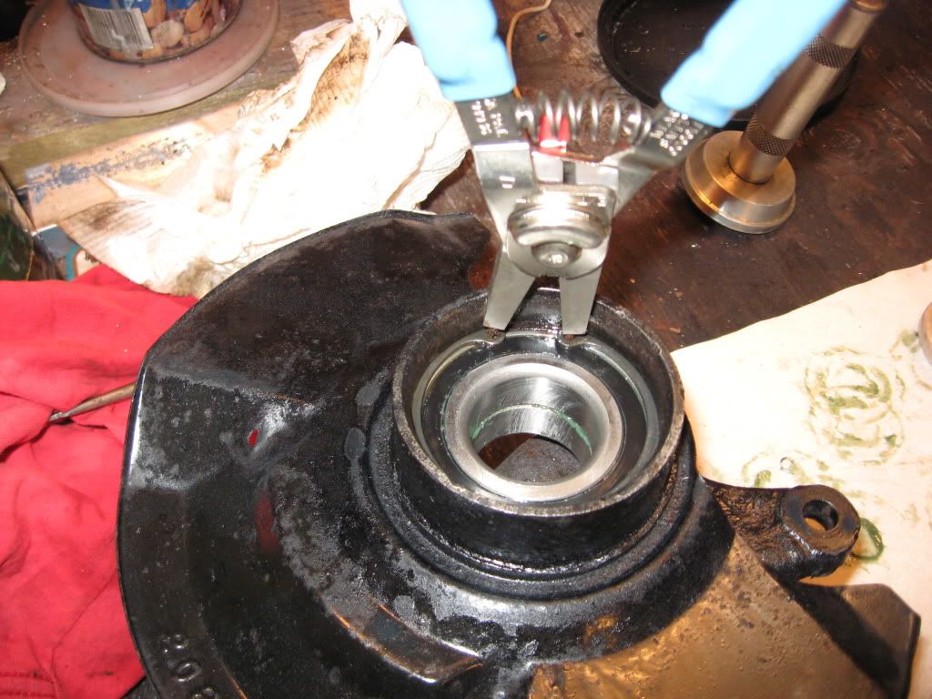

Here are a few tips to putting it all back together...
http://geometroforum.com/topic/5791643/1/?x=90#new

There is a bearing spacer on the earlier Metros that have inner and outer bearings, but the '95 and up use a single bearing. The inner race for your new bearing will most likely be stuck on the hub, so you will probably need another new bearing. Bummer. I have forgotten things like this a few times over the years, and it always sucks.
As for the binding, it may be possible that the bearing was not pressed all the way in to where it is seated. If the snap ring had fit in place, we could rule this out. I have seen a lot of folks have trouble with properly pressing in a wheel bearing, which is why I posted that thread that I linked to above. Next time I do a wheel bearing, I will make sure to get even more pics, so that I can update that thread even more. I think that I mentioned that it is easy to forget to replace the dust shield, seal, and snap ring before pressing in the hub, but I should have put even more emphasis on that. I have had a second new bearing deducted from my paycheck before as a professional mechanic, so I know how easy it is to forget these things and how much it sucks.
