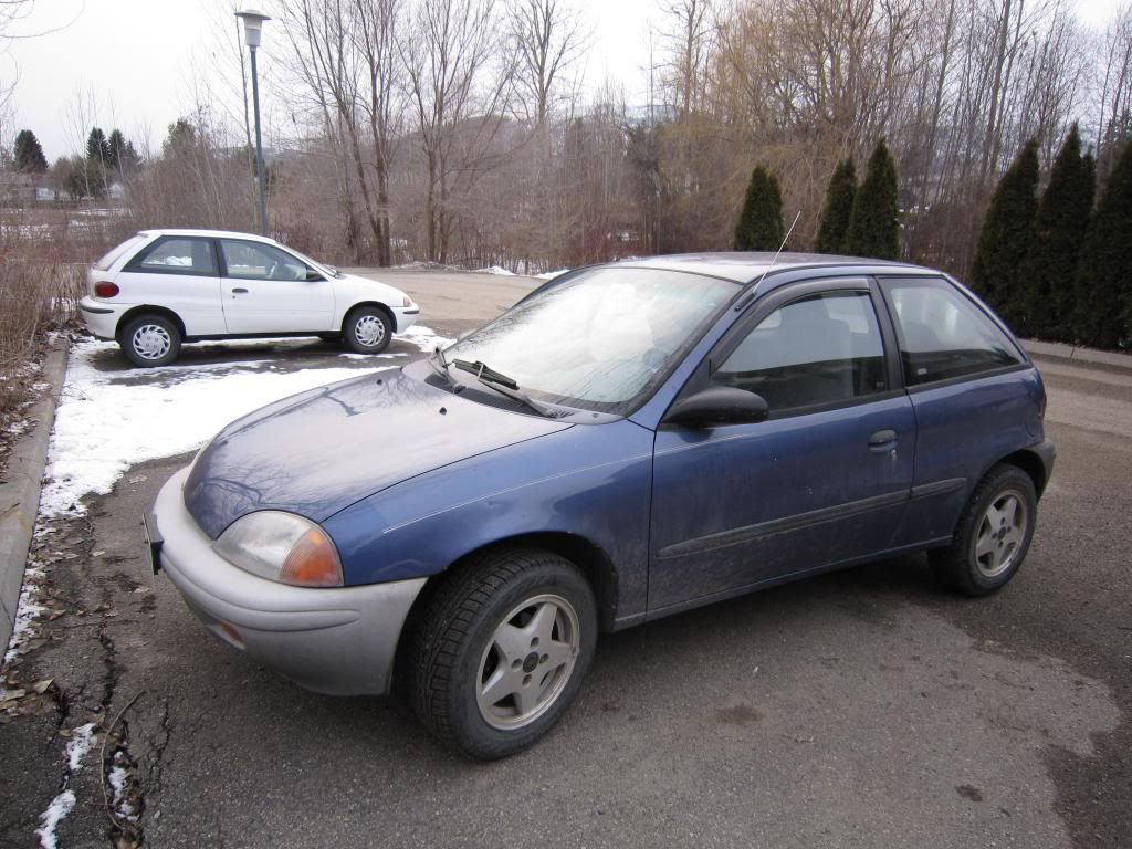

So I looked in your photobucket, this is the car/wheels that you like, and want a similar set to, is that correct?
Jenny
Yes, Mythstae! You're awesome! Those are both my cars. I currently have those nice rims from the blue swift put on my White Geo Metro, as that is the car I'm currently driving. My son will get the blue Swift when he starts driving on his upcoming birthday. However, I have a nice set of all-seasons that I want to put on my white Geo, but no rims for them. Instead of paying extra every time to have a shop switch them over, I thought I'd just get rims.

Do you know if they can still be found new? I've tried looking these up online at Costco and another local store, and it says there's nothing for my 1995. Surely they must be compatible for another make? It won't let me search by size, and it lists stuff with "kit" and stuff like that. I don't get it. Would a dealership sell 4x114.3 pattern ones? Or do I have to go to an auto wrecker to see if I can find something? I'd like something nice like what I have in the picture above for my blue car. Looks perfectly made for a 4-bolt pattern instead of 8 holes.
Yeah, I've never been a fan of multi-pattern wheels for that very reason! I just want my wheel to have the holes I need - no extra ones!
