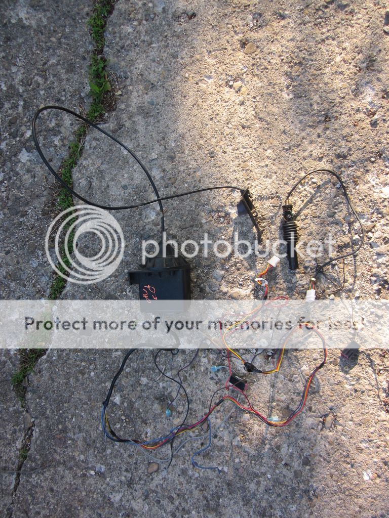

I went to pull a part yesterday and had the pleasure of Boogie Rat going with me. We walked the yard looking for cruise controls. There were plenty of cars with cruise on them but they were factory types. Boogie rat spotted one in the import section that was a aftermarket type. It is a vacuum style cruise and I think I can get it to work. Found a couple of websites that had the same type of unit put on metros. One thing it stated is I may have to put a vacuum canister on it to to get enough vacuum for it to work properly all the time.
Here's what we found.
Heck for $13 i think it worth a try.

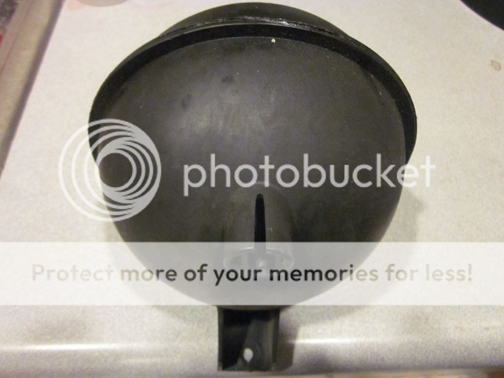

Is the type of canister you are talking about?
Should i take a hand type vacuum pump to test it to make sure it will hold vacuum?

That's your guy. The one you have a picture of has two holes; most of them only have one. If you find one with two holes, it may have a check valve built into it. Just follow the vacuum lines and you might find a check valve; they're all over the place.
No need to bring a vacuum pump. You can just suck out a good bit of air, put your finger over it, and if after about 2-3 seconds, as long as you get a "pop" when you remove your finger, you should be good to go. Very little to break. Besides, they're usually very cheap at the junkyard.
This one mounts very well under the left headlight. You will have to remove the bumper to get it in there but IIRC the front bumper is only held on with like four bolts. I did find the pics of how I mounted mine, I just need to get them posted. After you put the bumper back, you can't see it at all. If you're not concerned with how it looks, you can also bolt it to were the ABS servo sits under the brake booster. But like I said it looks MASSIVE under the hood. I have pics of some of this stuff over in my project thread The Story of Rudolph. That little reservoir just didn't cut it. :shake

Got me one. I now just have to find a wiring or installation manual for it. Have contacted Rosta but no reply yet. Not going to mount any thing until I find that. Seem like it is a older model that doesn't have tech support for anymore.
freegeo
Found a wiring diagram for it. Now the work begins getting the a location for the unit and getting the cable hooked up.
