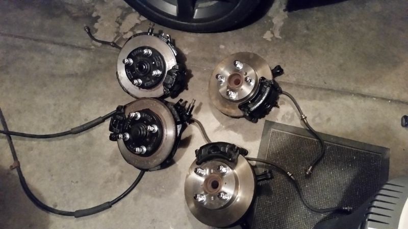

Just picked these up the other day. :rocker It was too good of a deal, this is the second set that I have. The first ones need a lot of work :smackface
As you can see the fronts have new rotors and pads, the rears have been turned with new pads and the calipers have been rebuilt with new bearings pressed in the rears. But I'm having trouble finding an OEM new or used Proportioning valve. I was thinking of going with the after market Russell from Oreilly. Any thoughts? Suggestions would be appreciated!

Thanks evmetro! :thumb Well I was told this because I'm going from drum to disk in the rear that I need one. If you have to slam on the brakes it keeps the back brakes from locking up first. The valve keeps most of the braking power on the fronts then it closes the backs. Our metro's have one built into the master cylinder but it's for rear drum. I think :D after I have looked it up on the web :smackface It has something to do with the drums start open then close when brakes are applied, if you swap drums for rear calipers the calipers are already closed, hence I need to regulate the rear calipers to keep them from locking up first. The Russell you can adjust up to 60%. Was also looking at the JEGS valve.

The factory proportioning valve is adjustable if needed. I ran my car with 98 front brakes with the GT rear discs for two years with the stock valve. Everyone said I needed to install the correct valve. When I installed the 1.3 I installed the GT valve, I could not tell any difference between the two. The car stopped great both ways, I would say try it. I drove it in snow and ice with no problems.

Thanks for the info :thumb Did you adjust the factory valve? and if you did was it by trial and error?

there's a steel cap clamped to the proportioning valve's body by 4 bent fingers. straighten out the fingers and pull the cap off. then you will see the stem and lock nut.
the proportioning valve's job is to adust the applied hydraulic pressure to the rear system so that the rear brakes don't lock up before the front brakes.
i have run the vert proportioning valve with the 4 wheel disc conversion but you can get your stopping distance tuned up by adjusting the valve. it takes some work and a lot of trial and error braking. ;)

Bout time you chimed in :D So do you think the best way to adjust it is put the car up on some stands(safely) no wheels and run the car and adjust the brakes or just find a vert replacement?

I did not adjust the factory 91 valve, and I could not tell any difference with the GT valve. And adjusting it in the air won't help, it is all about weight transfer and tire grip.

eventually i swapped in the gt proportioning valve. from what i can see there are 4 part numbers spread across the model ranges. they are the same valve, just different adjustments and parts numbers with different colors on the stickers.
one time i pulled the cap off a gt proportioning valve, loosened the lock nut, and counted the turns as i ran the adjuster screw in so i would know what the setting was for the 4 wheel disc brakes. i wrote the number down so i have it somewhere for reference but i forget where it is.
you won't hurt anything by running the base model geo metro proportioning valve, it just won't be the factory adjustment for the rear discs.
