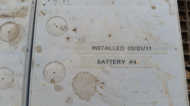

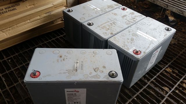

I had to make a run to a salvage yard today and ran across some Batteries that sparked my interest. The story goes that a contractor for cell towers dropped a bunch of them off there. Supposedly they are replaced per a time schedule and they are perfectly good. They want $30 each but I could prolly get 2 for $50.

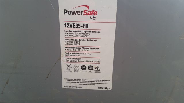

Do ya think it's a good deal? Ever heard of this brand?? Would the power ratings on the sticker be good for a Solar Project??
It is pretty hard to tell how much life is left in them, but if they are still good, that could be a pretty nice deal. A typical starter battery for a Metro has about 50 to 60 AH, and these are advertised at 98 AH The AH storage will go down as the battery ages, so it is hard to tell what is left in them. If they were only used for backup, they may still have some life left in them. Kinda sounds like a roll of the dice.
Rondawg
It's hard to tell from the photos but they are quite large. Darn things are 80 lbs!

For solar or back up battery systems; batterys are rated in hours rather than cranking amps. Deep cycle battery capacity is specified at a 20 hour rate. That means a battery with a 100 Ah rate will operate at a discharge rate of 5 amps for 20 hours ( 5A * 20h= 100 Ah). If a battery is operated at a higher discharge rate, it will produce less than the rated capacity. Such as a 100 Ah battery discharged at 10 amp rate will only produce appx. 93 Ah. If it is discharged at a 1 hour rate (100A), it will only produce appx 60 Ah of capacity. It destroys a deep cycle battery to fully discharge it so a rule of thumb is to have twice the capacity you will need so you never totally discharge them. If one of the batterys goes bad on a cell or repeater system they replace all the batteries as different age batteries dont work well together and cause melt down. If you bring your cheapy volt ohm meter with you and set it to DC volts, the batterys should read 12 to 13 or 14 volts. One of those batterys will test at 2.2 volts or more low. That will be the bad one. Our batterys on our system at work to back up our server has each battery that size at 2.2 volts each then are connected together till they equal 48 volts and are charged at 52 volts. As your batterys in the picture are 12 volt batterys they were likely tied together to equal 48 volts. They look like Sealed lead acid rather than Absorbed glass mat. AGM are the best but most expensive. Deep cycle batteries are nothing like automotive batterys in design or treatment. If you go to wall mart and look at their batterys you will see that the ones for motorhome and trolling motors are rated in appx 95 hours rather than 500 cranking amps. The deep cycles dont have much warranty if any. A automotive battery wont last long as a solar battery as they require immediate recharge when depleted and is why your 120 volt converter shuts down at 11 volts. (to avoid damaging your battery). By the way, your automotive alternator is a AC generator. The diodes couse the ac to become DC power because a diode is a one way electrical valve. Causuing the ac to become dc as it cant return to its source. In a nut shell; If you bypass the regulator and diodes, you have a speed regulated ac generator. At idle the alternator puts out appx. 38 volts. As you slowly increase speed you can stop and hold the voltage when your ac volt meter says 120 volts.if you keep increasing speed it might say 220 volts. Amps times volts equals watts.... 100 amp alternator times 120 volts equals 12 thousand watts. If increased to 220 volts = 24 thousand watts from your car alternator. That is why you can arcweld with a car alternator. Problem is the frequency is in excess of 400hz which is mostly used in aerospace applications. Will run resistive loads but not inductive loads. Your car alternator will run any motor with brushes such as Skil saws, jigsaws, electric chainsaws, vacuum cleaners, light bulbs, electric bathroom heater but wont run the fan because the fan is inductive and requires 60 hz to operate. This is the stuff one is forced to learn if they desire to survive off grid.
P.S. Those batterys in the picture have pressure valves in them to try to keep the electrolyte in them. DONT put one of these in a automobile as they require less than 15 amps preferrably less than 10 amps or they will boil or melt down or explode if charged at a high amp rate such as a automobile alterator does when you first start the car and the belts squeal for a few seconds.

From the specifications pages for these cells (http://www.nrsga.com/wp-content/uploads/2014/05/VE-Range-Summary.pdf)
"Charging current: PowerSafe VE can be safely recharged at high current rates."
They can also sustain 630 amps discharge for 2 minutes. More than enough for starting.
You'd want to be more careful with a gel cell, but these are AGM. They can handle high currents, and higher charge voltages than a gel could. Not so sure if they will appreciate the heat of an engine bay. Not that I suggest using one as a starting battery anyway, but you could if you really wanted to. and 80lbs is a bit heavy for a geo battery! :lol
PS: Haven't read all the replies, but I'd think these would make a great battery bank for a solar setup. They've probably lived 99% of their lives on a float charge, only being discharged occasionally when the power goes out. They're non-spillable(safer), no-maintenance, efficient (for lead acid, anyway), and can hold their charge for a long time between charges(low self-discharge). I'd grab my battery tester and snatch as many up as I could in your shoes.
