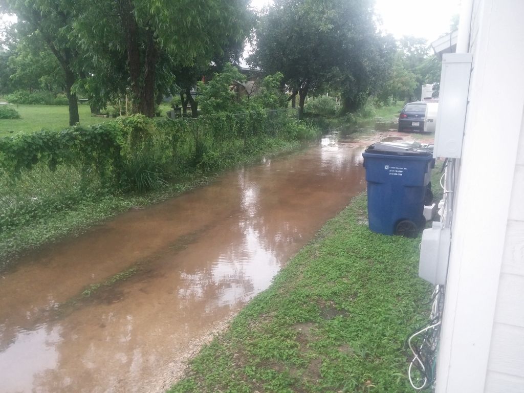

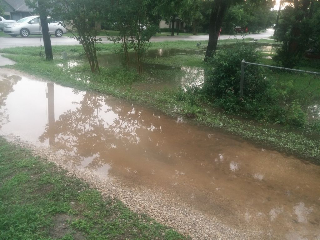

Still raining here...luckily in Texas we don't have basements...haven't been able to get to the garage in over two weeks without out getting the ole boots...and to think I'm not even in the flood range...it actually receded a little this morning
