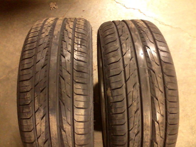

Check out the Toyo Extenza tires. Got 4 15" tires on my Magnum Metro and love them...........
