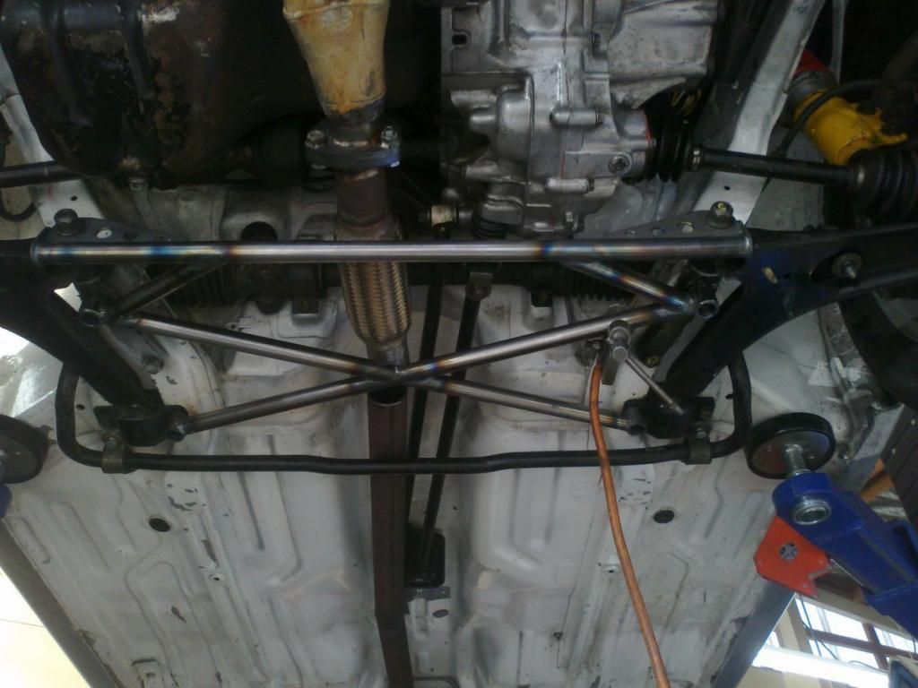

Now that everyone has debated it I'll explain why I suggested the rear sway bar and front brace, Perfesser and snowfish are right, the lower control arm(LCA) mounting points move a mile when cornering and particularly under braking, how can you control the suspension if it's not fixed in one spot? on my race car the LCA would spread so much under hard braking it would pull the left cv out of the gearbox, when we built the brace we made it slightly shorter and was going to use a block and tackle to pull the LCA together, ha, it was so weak we could push the LCA mounts together by hand to get the brace on.
Here's my 6 point brace

Nice brace you made there :wub:
Dattman
Express Shopper
Really??? in that case get a small front swaybar, a big rear swaybar together and then an underbody brace, you'll find a small rear sway bay without any front bar will actually be fine, I know of lots of racing guys who don't run a front swaybar and it doesn't turn their car into a tail happy monster at all, I'm just not a fan of running a front bar without a rear one.
MM nice to hear your first hand observation, mid corner correction, yes sounds like an improvement, not quite sure about a reduction in suspension noises from a top brace lol, have you tried a bottom brace?
Woodie just for you mate...
http://s64.photobucket.com/user/Downhillderek/media/Brace002.jpg.html

Very interesting points Dattman, and a very nice setup. I can order the front under brace from MAC and try to find sway bars later (since my usual pnp doesn't have much in the way of metro parts) and not going the ebay route for sway bars... I may be a little worried about solid tops on a metro though, thought it might put too much stress on the mounts, not sure though. I don't know a whole lot about suspension stuff. Just need a little more in the corners is all...
