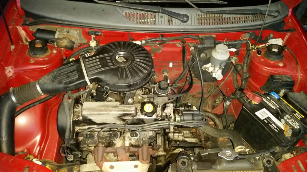

Here is how nasty it is... took a pic and had to do it with flash cuz its only 6:16 in the morning right now...

Number 1 in my book is "Gunk" brand engine degreaser in a spray can. Get the original & not foaming type. Don't cheap out & get an off brand like wmart or whatever. They don't work 1/2 as good. Gunk works best when you warm the engine up some, spray on, let it soak a few minutes, then use a heavy duty scrub brush to knock loose the crusty stuff. Hose off, done.
Number 2 would be Zep 505 from Home Depot. Gal jug & you need to put it in a spray bottle.
For really bad stuff, lather, rinse, repeat.
By the way, yours looks pretty clean compared to several I've seen.
