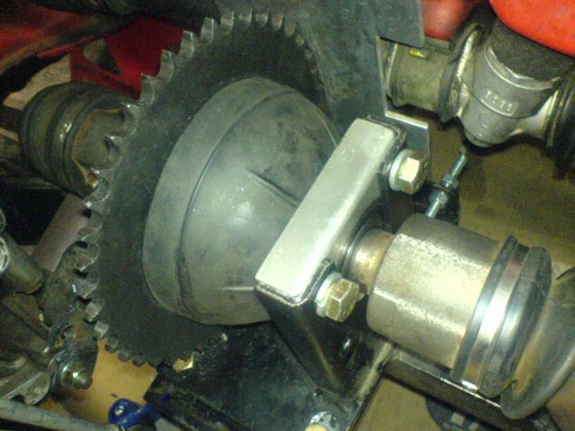

No drive axle in the back to turn, and somehow I think jbwelding a sprocket on the hubcap might not cut it... :hmm
Now there was this convertible conversion out west where someone welded the entire back half of a motorcycle to the back of the convertible and removed the two rear wheels. That looked pretty interesting. You should look into that idea if you're serious.

I think you've under-estimated the cost of the conversion.
You'd need the CBR engine and ancillaries (carbs, electrics exhaust) then make the mountings, electrickery and custom make the pipes. Then there's the throttle & clutch cables, extra long speedo drive and gear change mechanism to make. I'm pretty sure the CBR carbs are gravity fed too.
A switch for reverse? Switch what? You would need a separate electric motor to engage in to the drive train somewhere - saw one for $500...
So if you did all the work yourself, there's a few hundred dollars in bits and (if you're experienced) a few hundred hours of labour.
In the end you'll have a screaming bike engine guzzling petrol to propel something 4 times it was designed to do.
I'm not trying to piss on your bonfire - I've spent a hideous amount of money on my G10 conversion when I could have fitted a bike engine (and had people who had done it before to turn to for help). Even in my tiny car I wouldn't have picked a 600cc motor - you need a >900cc for the torque or you might as well remove all the seats in the car apart from the driver's.
You'd be better off financially, mentally and in time spent putting any Swift engine in that will fit.
