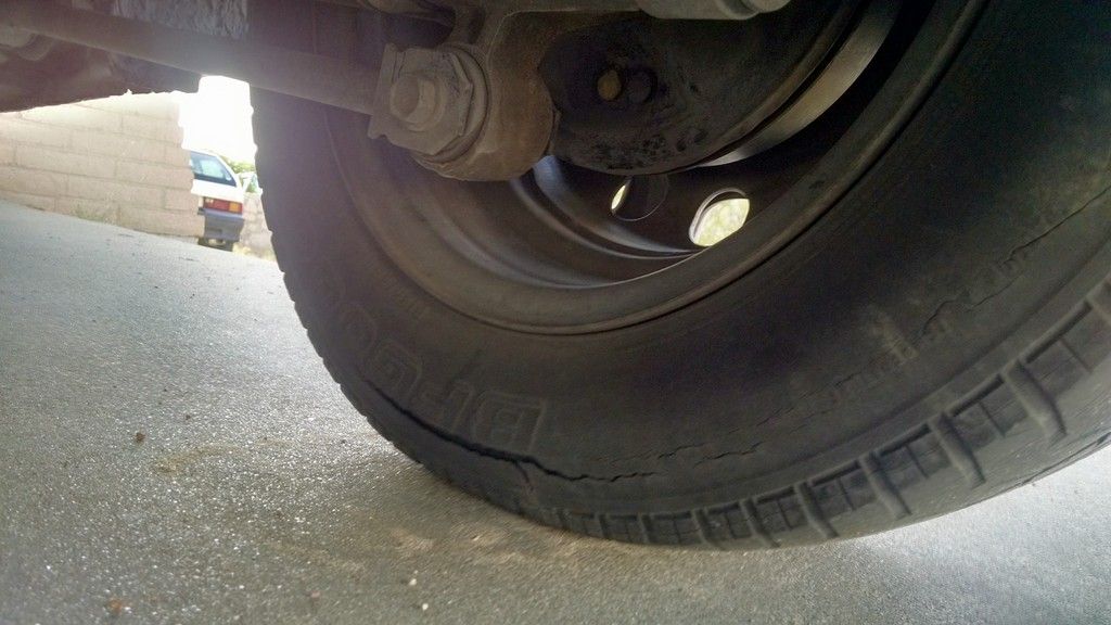

About a week ago I noticed my car began to hop slightly at speeds from 10mph to 40 mph, but only in the rear. I thought this was odd because I had just installed new struts/stabilizer links back there. I figured it was just the suspension settling but something didn't sit right with me. I took the car in for an alignment (because of recent suspension work) and it came back perfectly aligned but it still did the odd little hop. I put it in the back of my mind and got on the freeway to go home. Once I got home I had the feeling I should crawl underneath my car and when I did What a surprise I got! My guess is the previous owner drove the car with horrendously bad struts for so long that the force from the constant bouncing actually began to tear the sidewalls apart Needless to say, it got a full set of new tires today...Make sure to inspect your tires and suspension components regularly GMF, it could save your life. I'm surprised

The alignment shop didn't mention that to you? |

that looks like 'dry rot' from sitting too long |

Looks like an unlucky break to me! Or crack, at least! |

Looks like dry rot to me...glad you found it before it blew...hate changing flats on the side of the road, for some reason other drivers think your a target...

Looks like you came extremely close to unleashing a Goodrich Gator to lay out on the side of the road to get some sun. Glad you caught it, and thanks for that sober wake up call to check our tires better than just a quick look at the outside.
