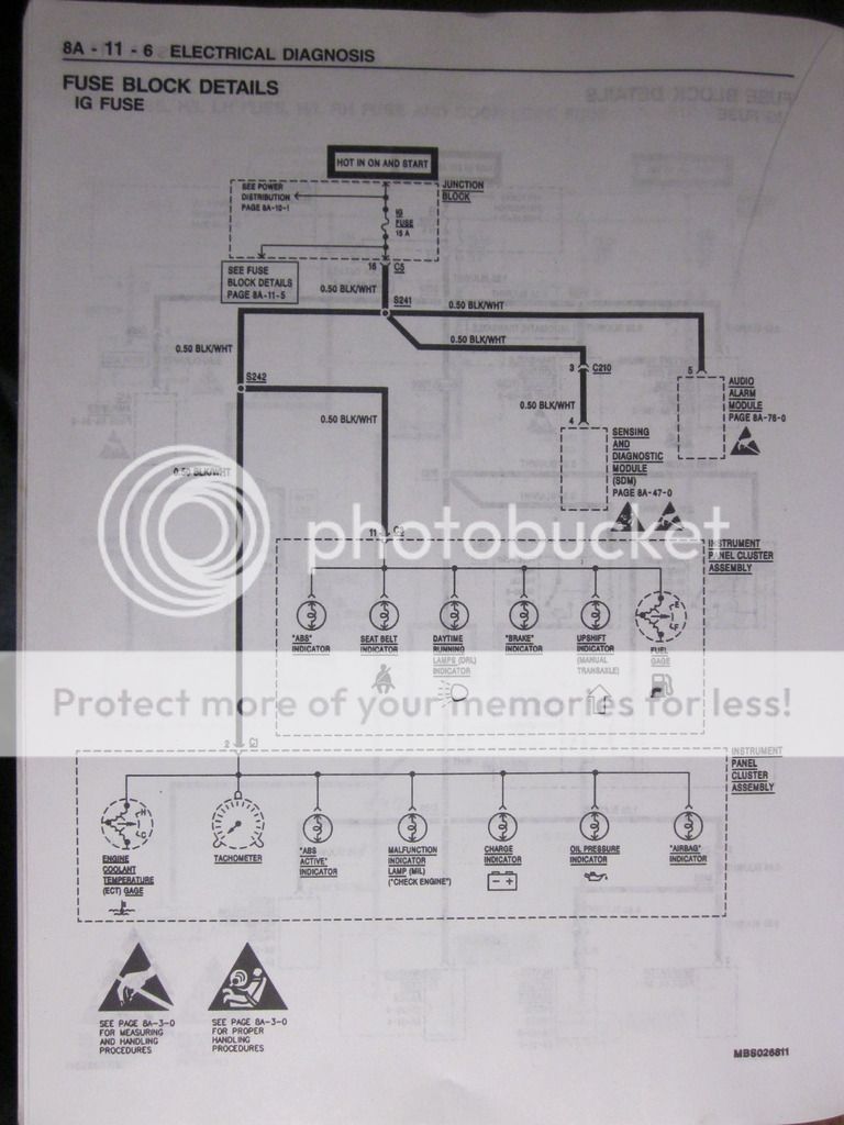

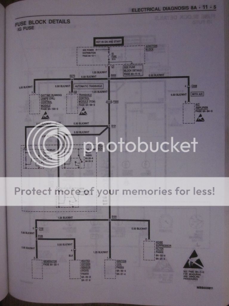

Here is the wiring diagram for the 95 15 amp ignition fuse. Unfortunately there are 12 different systems not including the cluster that feed off the fuse. Only thing I can think of off hand is to put a new fuse in and unplug the different components that feed off of the fuse. Turn the key on and plug one component in at a time and checking the fuse each time you plug something back in. If it blows with everything unplugged you have a short or bare wire in the wiring somewhere. Might want to start with the black white wire that goes to the alternator. ![]()
